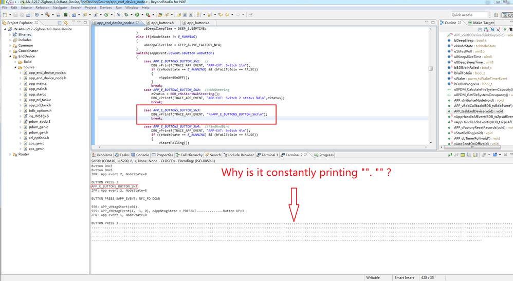

Why the terminal continue to output "."

When I press the button of SW3, the terminal as following.
Thans for your help.

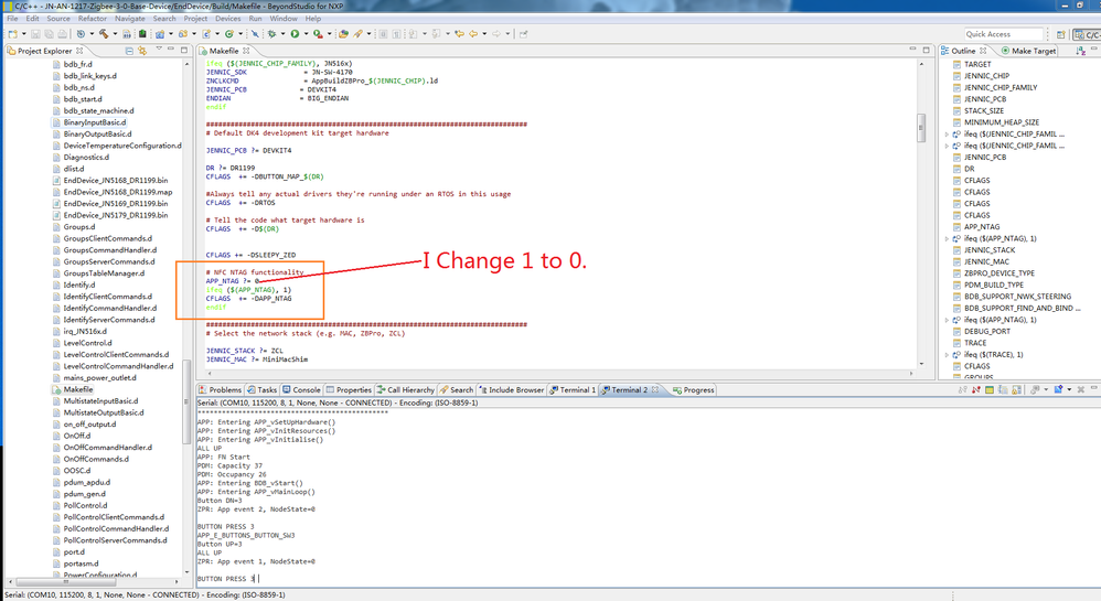

The reason may be that NTAG is turned on by default.
I am modifying it in the Makefile of EndDevice (it should be to turn off NTAG), "." is gone.
Is my way ok?

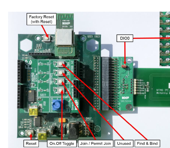

The Application Note: JN-AN-1217 ZigBee 3.0 Base Device documentation the button 3 (SW3)  is unused.
Mario
