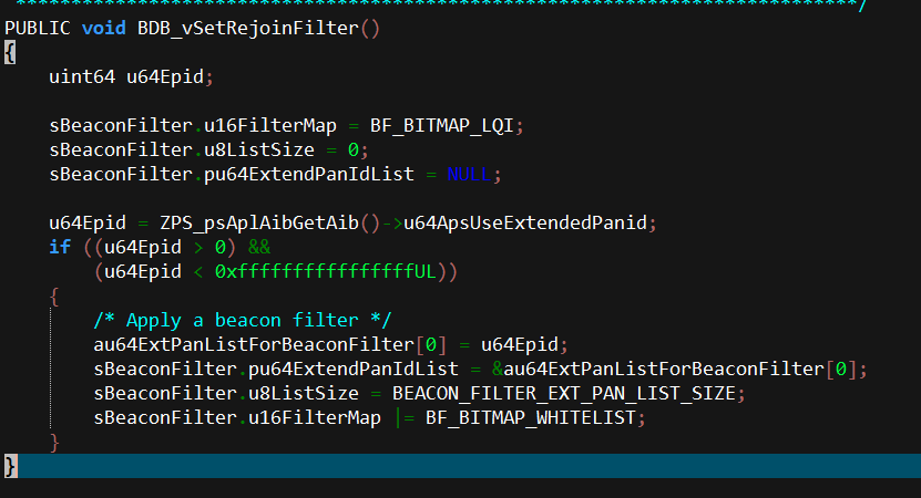

I am using JN5169 with JN-SW-4170 Zigbee 3.0 v1840.
Does this mean the parameter sBeaconFilter will not work?
BDB_vSetRejoinFilter() function code:

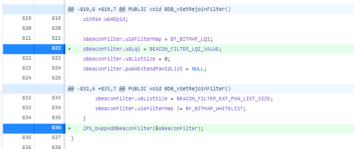

Is it OK If I change the code like this:

mario_castaneda
I am not sure what is the modification that you did.
The example that we provide shows the code:
sBeaconFilter.pu64ExtendPanIdList = NULL;
    sBeaconFilter.u8ListSize = 0;
    sBeaconFilter.u8Lqi = BEACON_FILTER_LQI_VALUE;
Note: If this is a whitelist, only beacons from networks with EPIDs in the list will be accepted
Mario

qingshuzhuang

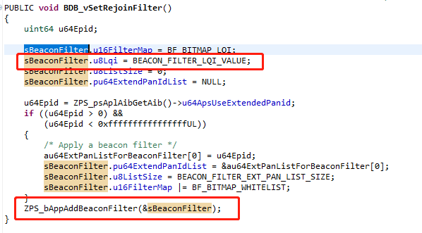

  This is my modification:
What is you SDK version?
I am using JN-SW-4170 Zigbee 3.0 v1840.
It seems my original code is not the same as yours.
Can you put all code about BDB_vSetRejoinFilter() function?
qingshu

mario_castaneda
I am working with the same SDK version.
PUBLIC void BDB_vSetRejoinFilter()
    uint64 u64Epid;
    sBeaconFilter.u16FilterMap = BF_BITMAP_LQI;
    u64Epid = ZPS_psAplAibGetAib()->u64ApsUseExtendedPanid;
    if ((u64Epid > 0) &&
        (u64Epid < 0xffffffffffffffffUL))
        /* Apply a beacon filter */
        au64ExtPanListForBeaconFilter[0] = u64Epid;
        sBeaconFilter.pu64ExtendPanIdList = &au64ExtPanListForBeaconFilter[0];
        sBeaconFilter.u8ListSize = BEACON_FILTER_EXT_PAN_LIST_SIZE;
        sBeaconFilter.u16FilterMap |= BF_BITMAP_WHITELIST;
Mario

qingshuzhuang
   Thank you for your reply.
   My original code is the same as yours.
   What do you think about the code I modified?is it necessary?

mario_castaneda
It depends on your requirement, what are you trying to achieve?
You are saving and filtering the Extended PAN ID, but are you trying to filter some devices?
Do you want to only permit some devices in your network? Did you try to change the network key?
Mario

qingshuzhuang
   Sorry i didn't make it clear before.
   I want the device to rejoin the network according to the LQI,Select parent node based on LQI。

mario_castaneda
By default, the device is looking for the network baes on the LQI.
Mario
