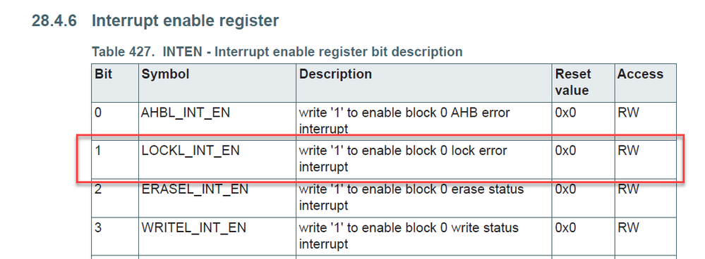

When you mention you clear the LOCKL_INT  how do you do it? According to the UM of the device the access to the register is only meant to be read .

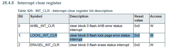

rickdickerson
Estephania,
Any insight into why the LOCKL_INT status flag is getting set when erasing unprotected pages?
I am using the LOCKL_INT_CLR bit in the INT_CLR register to clear the status flag.
