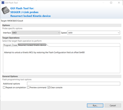

Ricardo_Zamora
From your console screenshot, your flash is write-protected.
Could you try to restore the Flash Configuration?
Ricardo

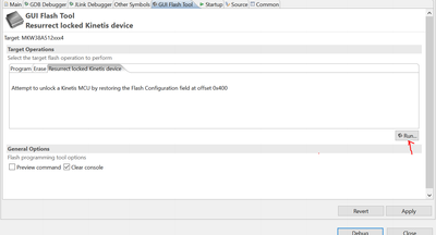

Javad_Baig
Sorry for the delayed response, I tried restoring the configuration by clicking on the below run button
after that I tried to Erase the Flash blank I am getting the same error i.e., Flash is write protected
Javad_Baig_1-1639387235011.pngJavad_Baig_1-1639387235011.pngJavad_Baig_2-1639387305364.pngJavad_Baig_2-1639387305364.png

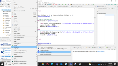

Javad_Baig
Thank you for your reply,
1) I used the below steps to flash the FRDMKW38,
2) I am using wireless uart freertos example code from the sdk to flash
3) I have changed the below text just to see changes are replicating(means updated code is flashing or not) but when I observed in serial monitor it is sending the old text only.
Note: the below text will print first once we run the example code after flashing
4) and also it is observed that when I start debugging, control is not coming to the main function(where I have put the breakpoint)

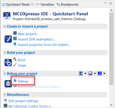

Ricardo_Zamora
Thank you for your reply. Could you please try to use the debug button?
And put a breakpoint in the line you modified. Are you able to get to that line?
Could you try with another SDK example?
