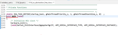

<i>. I am also using debug button only to flash the code and also I tried putting a breakpoint but it is not hitting both to the line which I have modified and also to the main function
<ii>. I have tried some 4 to 5 sdk examples, the behavior is the same
<iii>. I assume the execution starts from main function which I have mentioned below, the control is not hitting to this function

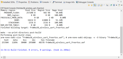

Is your project building without errors?

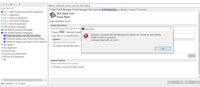

Can try using the GUI Flash tool in the MCUXpresso IDE to erase your device? Are you able to achieve this?

Yes my project is building without error, and no error found in the console. Executable is generating without any error
I tried to erase using GUI console it throw below error
In console the below error displayed
Note: - I am debugging using Segger J-Link probes, also I tried for MCUXpresso IDE Link server but it was not working

Ricardo_Zamora
From your console screenshot, your flash is write-protected.
Could you try to restore the Flash Configuration?

Sorry for the delayed response, I tried restoring the configuration by clicking on the below run button
after that I tried to Erase the Flash blank I am getting the same error i.e., Flash is write protected

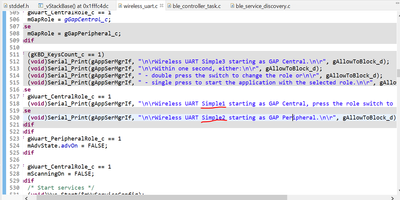

1) I used the below steps to flash the FRDMKW38,
2) I am using wireless uart freertos example code from the sdk to flash
3) I have changed the below text just to see changes are replicating(means updated code is flashing or not) but when I observed in serial monitor it is sending the old text only.
Note: the below text will print first once we run the example code after flashing
4) and also it is observed that when I start debugging, control is not coming to the main function(where I have put the breakpoint)
