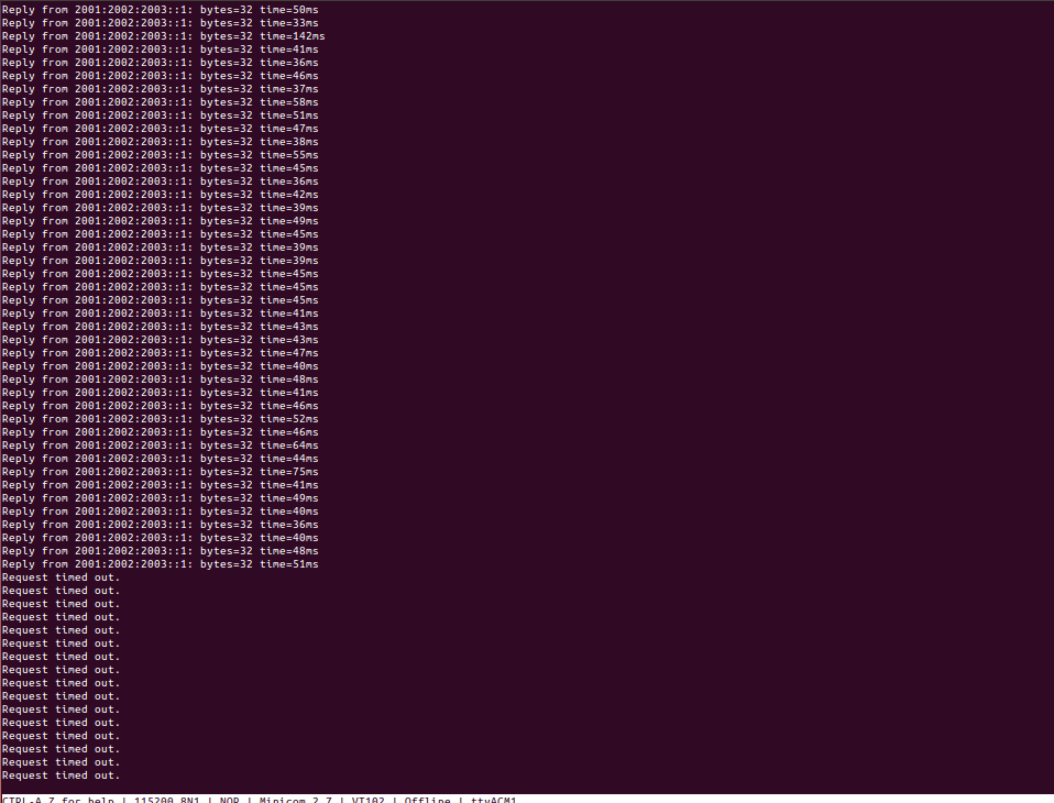

We have done bridging of eth1 and threadtap0 interface. I am not able to ping Router's IPv6 address 2001:2002:2003::1 from Linux PC, but still able to ping from REED. However, after some time ( approx. 50-60 ping response are received), ping response does not come from REED as well.

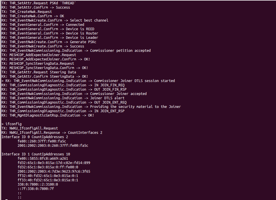

d) routerEligileEndDevice.txt: console of router eligible end device.

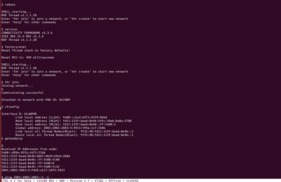

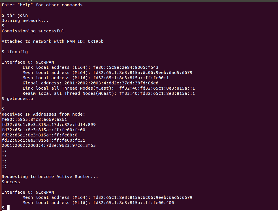

Thank you for your response. I have changed both Host and REED FRDM KW41Z board and surprisingly it is working. I am able to ping the router from REED. But I am not able to ping Border Router IP address from REED.
Steps:

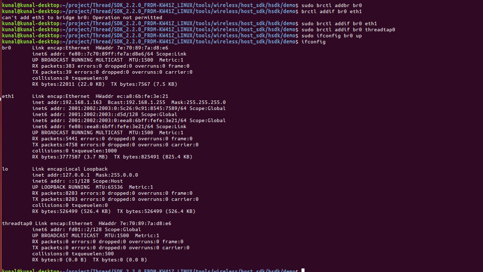

sudo ./make_tap.sh
sudo brctl addbr br0
sudo brctl addif br0 threadtap0
sudo brctl addif br0 eth1
sudo ifconfig br0 up
sudo dhclient br0
sudo dhclient -6 br0
sudo /sbin/ip -6 route add 2001:2002:2003::/64 dev br0
sudo /sbin/ip -6 route del 2001:2002:2003::/64 dev eth1
Screenshot for Border Router:
Screenshot for Host:
Screenshot for REED:

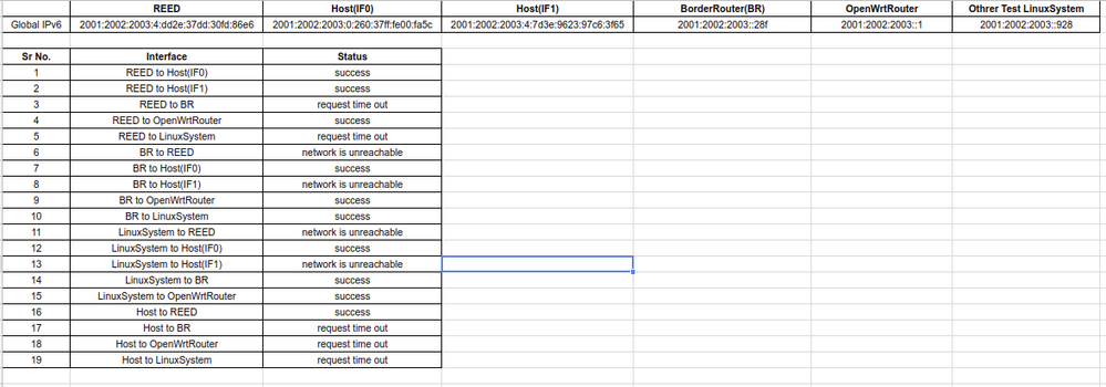

Screenshot for Other Test Linux System connected over Ethernet to router:
Screenshot for Ping status for all interfaces:
An IP address in below screenshot is taken from above screenshots (Please verify once if possible)pastedImage_8.png
I am not able to ping REED from x86 Linux system and Border Router. It would be great if you could help us on the same.

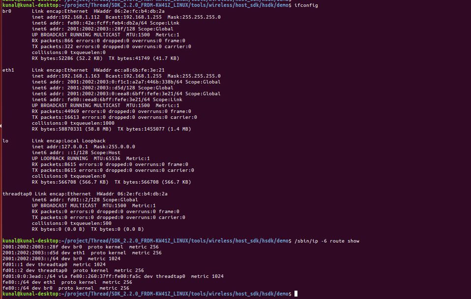

I am now able to ping REED node from Linux System. I just need to add the route and did it by rdisc6 command mentioned in https://community.nxp.com/docs/DOC-334294 .
Thanks a lot for your help and support.

Thank you for your response. I have gone through updated Thread Border Router using Linux + KW as Host Controlled Device with Serial TAP for DHCPv6-PD and followed the steps. However, REED is able to ping for few minutes only. Below are the screenshots:

We are using  'Thread_KW_Tun" application. We added the static route for the br0 interface. Now I am able to ping the router address 2001:2002:2003::1, but for only about 5 minutes. As you said, it seems that the host controlled application is having some issue. If we power cycle the Host Control device and run the "Thread_KW_Tun" application again then, REED is able to ping router for 5 minutes. So after every power cycle of the Host control device, REED is able to ping router for a very short time.
