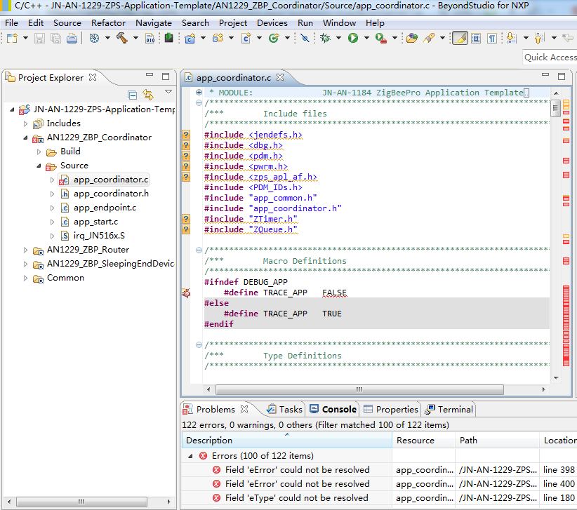

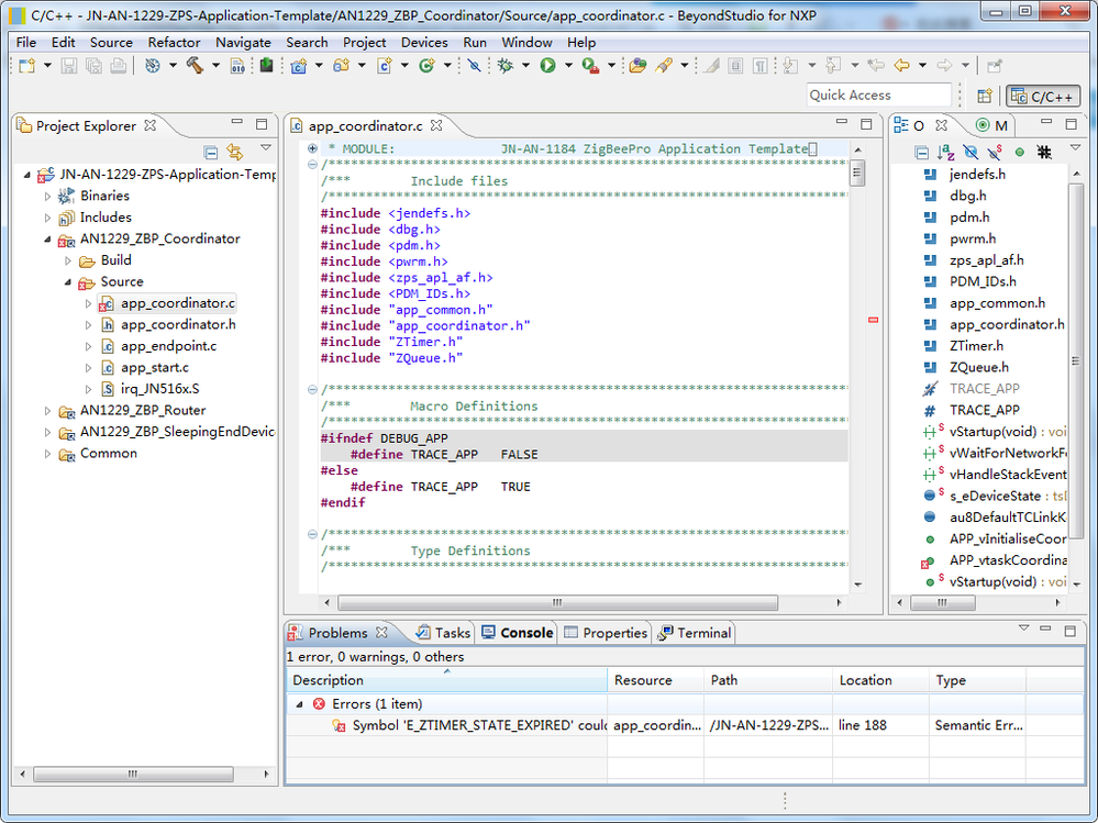

I used the 1229 to extract the 1229 zip to C:\NXP\bstudio_nxp\workspace。
There were no problems after the first Bulid all.But if I delete the project and import BUlid all again here, a lot of errors will occur.What should I do?

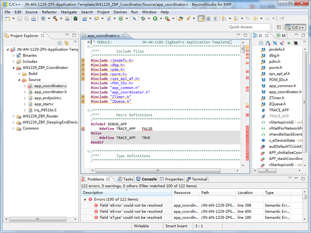

after    project ->Bulid all
If you delete a project and repeat the above operation, many errors will occur
project ->Bulid all
What should I do to be free from mistakes?

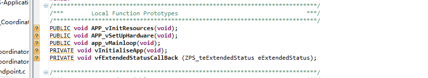

  • Is the following picture normal after compilation?
  • But a lot of header files and variables, you can't see the definition.Will this affect future development?
2,194 Views

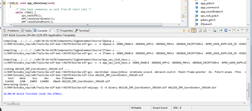

mario_castaneda
Hi Juan,
Yes, As you can see, you generated the AN1229_ZBP_Coordinator_JN5169.bin
But a lot of header files and variables, you can't see the definition. Will this affect future development?
No, you must take as reference the console log.
Mario
