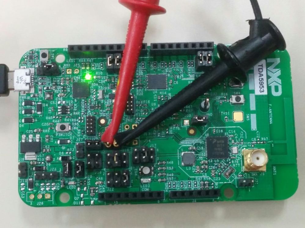

yaoxingshan
I will jump the cap into the following mode.
Then use a meter to measure the position of the image below:
When I press the button to join the network, the meter shows a power consumption of about 15mA.
Then I can see that the router's shell shows that it has agreed to join.
Finally, the meter showed that its power consumption dropped to about 4mA.
9,720 Views

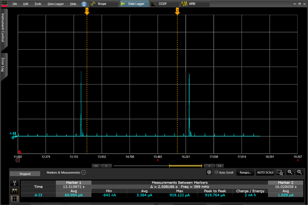

Alexandru-Lilia
I've tried to do the measurement in buck-mode as you did and I came across some problems:
  • the board was always resetting if I had the multimeter connected as shown in the image; I don't know why it does, probably the internal resistance was not suitable for such measurement; when I used uA scale it didn't work, but when I used mA scale it worked, but I don't know how precise the measurement was;
  • when in buck-mode, you should define gDCDC_Enabled_d to 1, in config.h;
  • if you are using revision A3, on the back of the board is a shunt resistor, SH503, which powers the LEDs, which consumes a considerable amount of power; scratch it with a cutter, and don't worry, you can remake the connection with a little bit of solder;
This is a measurement with a very high precision multimeter, in buck-mode, as in the picture you attached:
As you can see, the average is 3.364 uA.
Regarding the measurement in bypass mode as I've explained to you, it probably is that high because something on the board has broken. It happened to me too on a board after I changed the jumpers while being connected to the power source. At least that's what I think.
Good luck.
