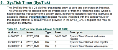

I am using the PN7462 microcontroller. There are only 4 timers in PN7462 and I have exhausted those timers. I have a requirement to calculate 5Min time. There is a workaround that I put a counter in a milli-second timer and calculate 5 minutes but I looked into the PN7462 datasheet and there is a SysTick Timer. Is there a way I can use this timer for generating interrupts at a given time?  I am using bare-metal programming.

Yes, it's possible. But 24-bit counter does not reach 5min by an interrupt. So, it is recommended that you do this, interrupt once every 10 seconds, overflow after 30 interrupts, and continue to reload the counter value if it does not reach 30 times. In this case, 30*10s=300s=5min.
