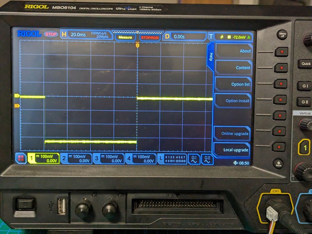

We should focus on execution time of the function vMMAC_Enable().  My first question is it's anormal or not.
How are you setting/configuring this timer? What is the procedure you are using to measure this time/interval? Which events are you using to trigger the measure?
Problem is NOT timer use. I double check with GPIO control and see with oscilloscope. (note: VCC level is 0V)
Here is the abbreviated code.

  vMMAC_Enable(); // THIS TAKES APPROX. 80ms
  __DGC_SetHi(); // SET GPIO PORT

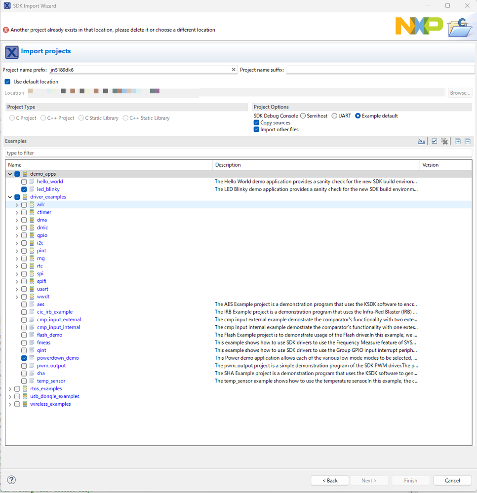

Just to confirm, which template/example project are you using as base for your development?
I will check on this issue. Please, give me some time, as soon as I have some information to share, I will reply to you.
Both are from SDK2_6_10 sample code and I tried to minimize the modification.
  • ledblinky --> call vMMAC_Enable() on coldboot, check with PIO.
  • powerdown_demo --> call vMMAC_Enalbe() both on coldboot and warm boot, check with WTIMER count at warmboot.

I made a quick sample from "SDK Samples -> demo_apps -> led_blinky". It still take 77ms with with the simple sample (not tested at warmboot).
