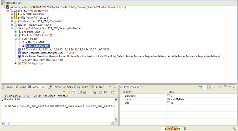

I am new to Zigbee and I've been trying simple data transfer between two JN5168-001-M00 modules , using Zigbee 3.0 ( JN-SW- 4170 ) and Application Note AN 1229.
The destination get notified correctly when a message arrives , yet I couldn't read the payload successfully.

Do you have any APDU changes to ZBProAppTemplate.zpscfg ?

Hi, please have a search for 'PDUM_u16APduInstanceWriteNBO' in the file "C:\NXP\bstudio_nxp\sdk\JN-SW-4170\Components\ZCIF\Source\zcl.c" for some usage on that API.
Try to also set the setsize or setpayloadsize.
14,416 Views

I've tried this and I don't think the problem is in writing the payload at the sender node
I tried debugging the instance returned on event occurrence at the receiver node and it gives me invalid handle!
This is how I deal with the coming message
uint8 u8Payload;
PDUM_u16APduInstanceReadNBO(sStackEvent.uEvent.sApsDataIndEvent.hAPduInst,0,'b',&u8Payload);
on trying to print the value of 'u8Payload' it always gives me '0' not matter the actual payload I wrote on the sender node
and also by trying checking the handle 'sStackEvent.uEvent.sApsDataIndEvent.hAPduInst' it gives invalid handle!

limcb
You need to call your ReadNBO routine at :
vHandleStackEvent in app_router or
APP_vtaskMyEndPoint in app_endpoint
It gets cleared as soon as it exits the function vHandleStackEvent or APP_vtaskMyEndPoint.
The stack processes the Event only once then forgets all about it as soon as it leaves the 2 function above.
You may not declare ZPS_tsAfEvent sStackEvent; anywhere in the program and ReadNBO it.
( at least I think what is happening here )

Hello Sir,
I am working on ZigBeePro Stack. I have install ZPS Editor.
and set parameter as per JN-UG-3113 PDF.
i create APDU by name "TestApdu" in Sleeping Endevice.
i have added screen shot so you will understand better.
how to remove that error?
please suggest me something.
i am really stuck on it.
Thank You For Your Reply.
