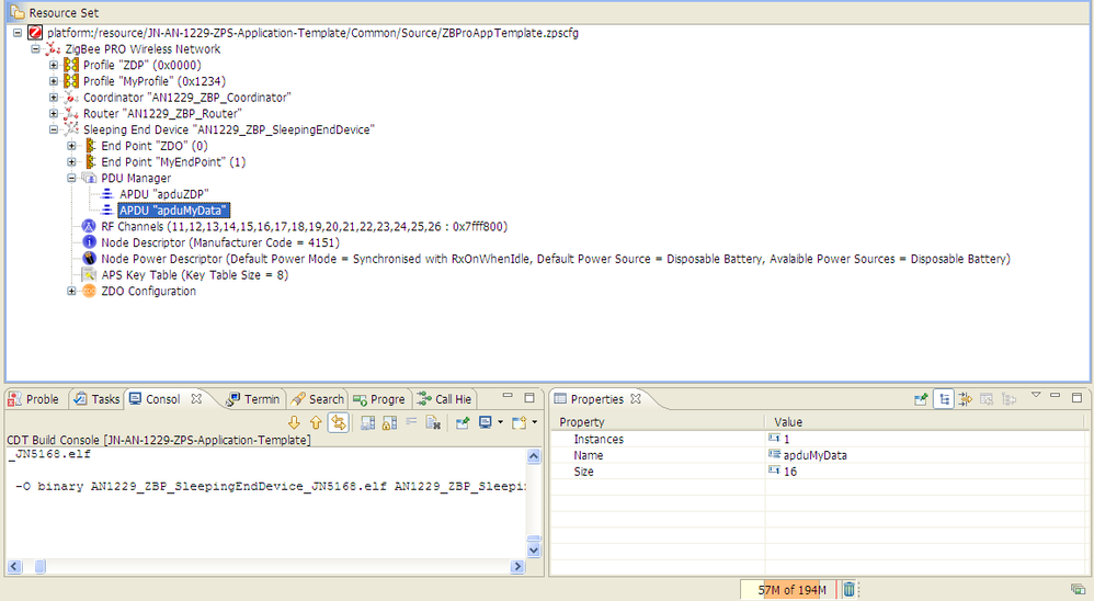

I am new to Zigbee and I've been trying simple data transfer between two JN5168-001-M00 modules , using Zigbee 3.0 ( JN-SW- 4170 ) and Application Note AN 1229.
The destination get notified correctly when a message arrives , yet I couldn't read the payload successfully.
on the SED node
PDUM_thAPduInstance myInstance =PDUM_hAPduAllocateAPduInstance(apduMyData);
PDUM_u16APduInstanceWriteNBO(myInstance,0,"b",5);
ZPS_teStatus myStatus= ZPS_eAplAfBroadcastDataReq(myInstance,1234,1,255,ZPS_E_BROADCAST_ZC_ZR,ZPS_E_APL_AF_UNSECURE,0,NULL);
on the coordinator endpoint
uint8 u8Payload;
PDUM_u16APduInstanceReadNBO(sStackEvent.uEvent.sApsDataIndEvent.hAPduInst,0,'b',&u8Payload);
whatever the message I try at the SED node , when I check the payload of the coming message it gives 0.
Any one can help ?

Certainly odd, I just added a ReadNBO (lines 11-14), rebuild SED and broadcast from Coordinator and it works.
case ZPS_EVENT_APS_DATA_INDICATION:
     DBG_vPrintf(TRACE_APP, "APP: APP_taskEndPoint: ZPS_EVENT_AF_DATA_INDICATION\n");
     /* Process incoming cluster messages for this endpoint... */
     DBG_vPrintf(TRACE_APP, "    Data Indication:\r\n");
     DBG_vPrintf(TRACE_APP, "        Profile :%x\r\n",sStackEvent.uEvent.sApsDataIndEvent.u16ProfileId);
     DBG_vPrintf(TRACE_APP, "        Cluster :%x\r\n",sStackEvent.uEvent.sApsDataIndEvent.u16ClusterId);
     DBG_vPrintf(TRACE_APP, "        EndPoint:%x\r\n",sStackEvent.uEvent.sApsDataIndEvent.u8DstEndpoint);
     uint8 u8TempPayload;
     uint16 u16bytesread;
     u16bytesread = PDUM_u16APduInstanceReadNBO(sStackEvent.uEvent.sApsDataIndEvent.hAPduInst,0,"b",&u8TempPayload);
     DBG_vPrintf(TRACE_APP, "Read: %d, Data: %c", u16bytesread, u8TempPayload);
     /* free the application protocol data unit (APDU) once it has been dealt with */
     PDUM_eAPduFreeAPduInstance(sStackEvent.uEvent.sApsDataIndEvent.hAPduInst);

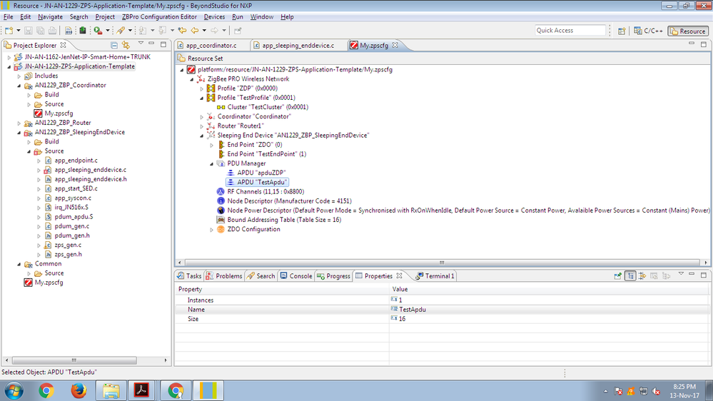

Do you have any APDU changes to ZBProAppTemplate.zpscfg ?
Edit: I'll try the reverse like your case, SED -> Coordinator.
Just hardcoded a quick broadcast code to the SED. It works.

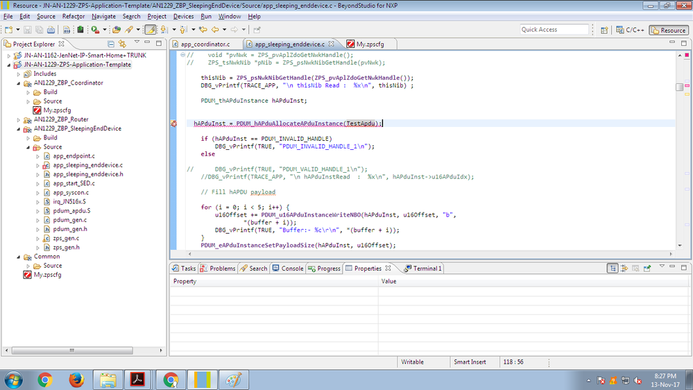

PUBLIC void vWakeCallBack(void)
    /* schedule device to go to sleep, then poll for data */
    DBG_vPrintf(TRACE_APP, "APP: Polling for data\n");
    ZPS_eAplZdoPoll();
     uint8 u8TransactionSequenceNumber;
    ZPS_tsNwkNib * thisNib;
    thisNib = ZPS_psNwkNibGetHandle(ZPS_pvAplZdoGetNwkHandle());
    PDUM_thAPduInstance hAPduInst;
     hAPduInst = PDUM_hAPduAllocateAPduInstance(apduMyData);
     uint16 u16Offset = 0;
     uint16 i;
     // Fill hAPDU payload
     u16Offset = 0;
     uint8 buffer[] = "idontknow";
     for (i = 0; i < 5; i++) {
          u16Offset += PDUM_u16APduInstanceWriteNBO(hAPduInst, u16Offset,"b", *(buffer + i));
          DBG_vPrintf(TRUE, "%c", *(buffer + i));
     PDUM_eAPduInstanceSetPayloadSize(hAPduInst, u16Offset);
     DBG_vPrintf(TRUE, "Size : %d\nSending : \n", PDUM_u16APduInstanceGetPayloadSize(hAPduInst));
     if (hAPduInst == PDUM_INVALID_HANDLE)
          DBG_vPrintf(TRUE, "PDUM_INVALID_HANDLE\n");
     } else {
          ZPS_teStatus eStatus;
          ZPS_teAplAfSecurityMode  eSecurityMode = (ZPS_E_APL_AF_SECURE_NWK);
          eStatus = ZPS_eAplAfBroadcastDataReq(     hAPduInst,
                                                     0x1337,
                                                     0x01,
                                                     0x01,
                                                     ZPS_E_BROADCAST_ZC_ZR,               //     Dest: All Coordinator & Routers
                                                     eSecurityMode,
                                                     0,
                                                     &u8TransactionSequenceNumber

Hi, please have a search for 'PDUM_u16APduInstanceWriteNBO' in the file "C:\NXP\bstudio_nxp\sdk\JN-SW-4170\Components\ZCIF\Source\zcl.c" for some usage on that API.
Try to also set the setsize or setpayloadsize.

I am doing the same thing but its showing me error
!!! Alignment error
i check the code this error comes after
i read thisNib Value its show
thisNib Read :  4001944
i think problem is in this line--> hAPduInst = PDUM_hAPduAllocateAPduInstance(apduMyData);
After that i saw below message
!!! Alignment error
u32PICMR = 0 : u32PICSR = 8
u32PICMSR = 0 : u32IPMR = 4
u32IHPR = 7 : u32AINT = 8 u32PINT 0
EPCR = 8840b : EEAR = deadbf55
 then long values comes continuously
  4007a18 : 0000000c
 4007a1c : 0008840b
 4007a20 : deadbf55
 4007a24 : 00000000
 4007a28 : 00000007
 4007a2c : 00000004
 4007a30 : 00000008
 4007a34 : 00000000
 4007a38 : 00000000
Like this and
after that my
device reset by watchdog timer
APP: Power Up
APP: Watchdog timer has reset device!
:smileysad: too bad for me.
can i get your help.
 Please need your help!
Thank you for your Time!

I am working on ZigBeePro Stack. I have install ZPS Editor.
and set parameter as per JN-UG-3113 PDF.
i create APDU by name "TestApdu" in Sleeping Endevice.
i have added screen shot so you will understand better.
how to remove that error?
please suggest me something.
i am really stuck on it.
Thank You For Your Reply.
