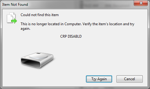

2.  When I short JP15 and reset the board, I get an autoplay message:
Any attempt to copy in a new firmware.bin (from the SDK sample projects) image fails:
I'm not yet sure what CRP DISABLD means but I assume that it's not good and that my board is likely hosed somehow.  Any suggestions on how to recover?

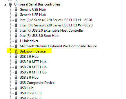

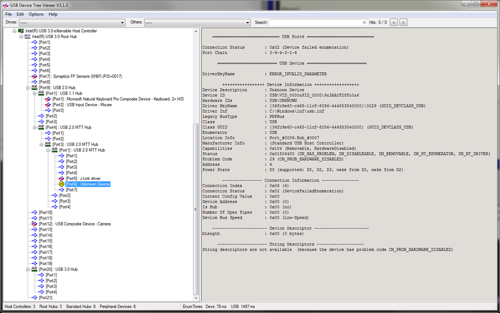

3.  I am working on our own board with the same MCU.  I can flash directly via an external JLINK and IAR.  When I try to go into ISP mode, the device shows up as an unknown USB device. :
This implies that I'm missing some sort of setup step that configures the ISP mode to a particular vendor/id, no?  I have found no documentation thus far on how to accomplish this.

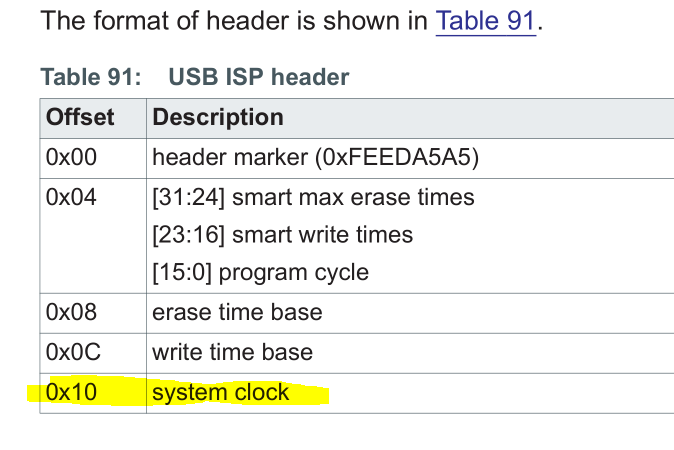

Great Success!
My problem was due to the 16Mhz clock.  I swapped it out for a 32Mhz and I was able to update the firmware as expected via the ISP USB interface.  Hopefully somebody finds this soliloquy useful.
NXP - please provide some guidance on what to do for 'nonstandard' board configurations.

So the system clock field in the USB ISP header appears to be none other than the SYSCON_CLK_CTRL register.  I'm assuming that this is used to update the reset value so that the next time the system boots it uses it.
I now have a bootstrapping problem.  How do I get the ISP to boot with my 16Mhz clock so I can write a firmware image that will configure the ISP to use the 16Mhz clock?

I just discovered the system clock field in the USB ISP header.  The DK is running a 32Mhz clock and I'm running at 16Mhz.  This could explain my issues.
The Image editor tool doesn't allow me to change this setting and there's no docs on the format.  The tool spits out a value of 0x403c0010 which is most certainly not 32m.  I can jam a value into the image.  Can someone tell me what this field should look like for a 16Mhz clock?

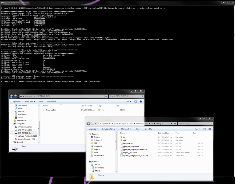

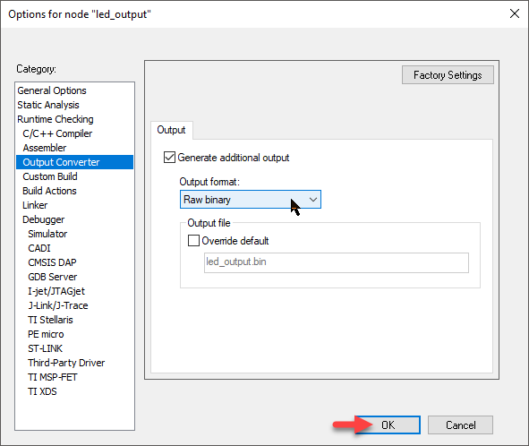

The outlined firmware update path doesn't work for me.  Here's what I did:
  1. Opened the led_output project from a freshly installed 2.2 SDK.
  2. Changed the output filename extension from .out to .bin
  3. Compiled project
  4. Copied QN908x_Image_Editor_v1.0.0.exe and libgcc_s_dw2-1.dll into the debug output folder
  5. Ran the image editor to create a valid .bin:  QN908x_Image_Editor_v1.0.0.exe -i gpio_led_output.bin -u
  6. Applied power to my DK board with JP15 shorted
  7. Opened the CRP_DISABLD drive and erased the firmware.bin contained inside
  8. Copied the firmware.bin that was generated by the image editor into the CRP_DISABLD drive/folder
  9. Rebooted board 5 seconds after copy was done
After these steps the DK board is not only not blinking the LED but is also unresponsive to the CMSIS-DAP interface.  I cannot flash, erase or otherwise talk to it from the debugger.  It does reliably boot into ISP mode however.  To get it back I had to resort to a standalone JLINK debugger.  After a few attempts I was able to erase the chip.  After that the CMSIS-DAP interface behaved as expected.  I believe this is the state I initially described in this thread.  I suspect that another developer had tried to flash in this manner and got to the same point I did before giving up.
Here's the output of the script and the associated files:

gerardo_rodriguez
Hello Jose,
The *.out file from IAR is not the application binary file. To generate the binary file from IAR you can do it from the project options:
The bin file should now be generated in the Debug folder and should be around 15KB for the led_output example. Please try with this file instead and let me know if you were successful.
Gerardo

joseraffucci
Bingo.
Small but important checkbox.

CRP DISABLD means that the Code Read Protection security is disabled.

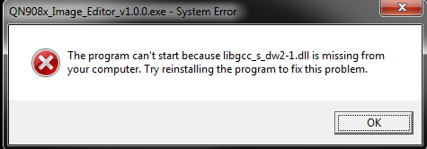

FYI -- the QN908x Image Editor binary isn't statically linked:
See: c++ - Program can't find libgcc_s_dw2-1.dll - Stack Overflow
Can you either re-link or provide the correct missing libgcc version?
22,913 Views
joseraffucci
The missing library can be found at C:\MinGW\bin\libgcc_s_dw2-1.dll by installing MinGW.  I can't remember which component contained it.  Either the base or the gcc/g++ one.
Copy the DLL  in whatever folder you're trying to run the image editor from and you should be good to go until NXP relinks the binary.

I figured out how to do the update on the DK board, it's our custom board that I'm having issues with.  When I short the equivalent of JP15, I don't get a mass storage device but rather an USB/UKNOWN one.  The DK board shows up as a mass storage device on the same computer.
What I'm reading from your response and from the brief USB ISP section from the UM is that both the DK and the standalone IC handle updates in the same manner -- mass storage device/firmware.bin, etc.  Correct?
How is the ISP USB descriptor configured and more importantly, who's responsible for that?  Me or the factory?   I can't find anything the UM to guide me on this or explain what the default settings are.
