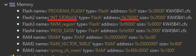

1. I changed the gAppOtaExternalStorage_c flag to use the internal memory:
2. I changed the memory partioning, more specifically I reduced the size of "PROGRAM_FLASH":
And reduced the size and starting address of the OTAP dump address "INT_STORAGE":

My OTA application works fine when using the default location, 0x7a000 for "INT_STORAGE" (memory section for receiving and storing sb3 file). However, when changing the "INT_STORAGE" to a lower address it seems the OTAP process erases the contents of my newly defined "INT_STORAGE" and therby the new sb3 image.
To verify this, I modified the "INT_STORAGE" by two sectors, from 0x7a000 to 0x76000, as seen in the image below.

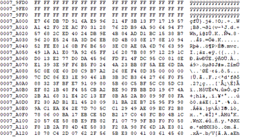

Prior to initiating OTAP, the dump address "INT_STORAGE" is empty as seen in the below image.

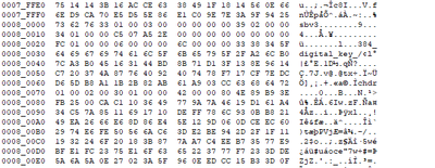

I then initiate the OTAP and set a breakpoint in the "OTA_SetNewImageFlagWithOffset" function, since the image transfer is complete upon entering this function. At this time we can observe that the sb3 image is stored at the new dump address (0x76000), see image below.

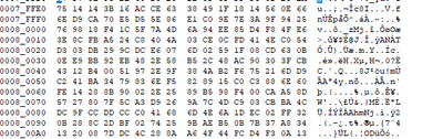

Once the OTAP sequence is finished, i.e. the device has rebooted it is no longer functional. The memory at the start address explains this.. see image below. The new application is only written up untill address 0xb0.

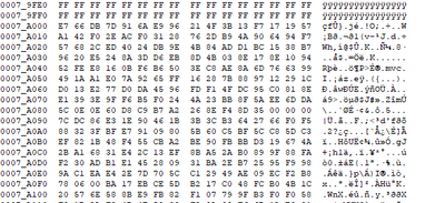

However, if we look at the default dump address (0x7a000), it still holds data.
Additionally, if we compare the contents of the default "INT_STORAGE" (0x7a000) with the contents of the sb3 file I sent over with an offset of 0x4000, i.e. what was written at address 0x7a000 before the reboot, we can see that it matches up perfectly.
This leads me to believe that the first 16kB or 0x4000 bytes of the sb3 image are erased during the reboot of the OTAP process and as such the sb3 file fails to be processed.

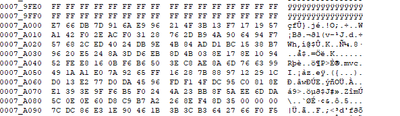

I did the same experiment but moved the dump address the other direction, i.e. one sector higher (0x80000). During this experiment the OTA succeeds but the same behavior can be observed in the memory. Default "PROGRAM_FLASH" section is erased, i.e. 0x00 -> 0x7a000. The below screenshots show the memory of the device prior to OTAP initialization, showing that the default "INT_STORAGE" remains unchanged.
I then continue to do the same OTAP sequence as previously and break at the same location. At this point the memory at the default "INT_STORAGE" address is identical as prior to the image receival.
However, the memory at the new dump address (0x80000) is showing the start of the sb3 file.
And the OTAP is successful in booting the new image after the reboot.
