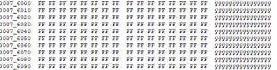

Prior to initiating OTAP, the dump address "INT_STORAGE" is empty as seen in the below image.

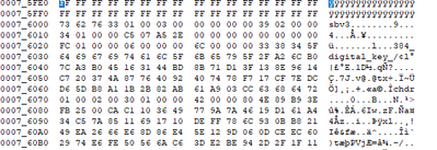

I then initiate the OTAP and set a breakpoint in the "OTA_SetNewImageFlagWithOffset" function, since the image transfer is complete upon entering this function. At this time we can observe that the sb3 image is stored at the new dump address (0x76000), see image below.

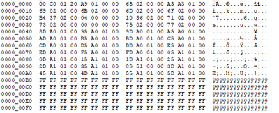

Once the OTAP sequence is finished, i.e. the device has rebooted it is no longer functional. The memory at the start address explains this.. see image below. The new application is only written up untill address 0xb0.

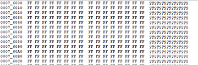

If we look at the new dump address "INT_STORAGE" (0x76000), it too is cleared.

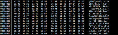

Additionally, if we compare the contents of the default "INT_STORAGE" (0x7a000) with the contents of the sb3 file I sent over with an offset of 0x4000, i.e. what was written at address 0x7a000 before the reboot, we can see that it matches up perfectly.
This leads me to believe that the first 16kB or 0x4000 bytes of the sb3 image are erased during the reboot of the OTAP process and as such the sb3 file fails to be processed.
