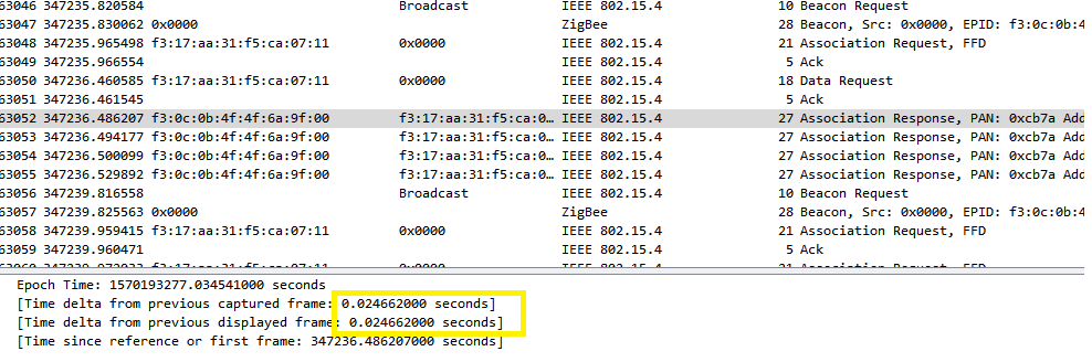

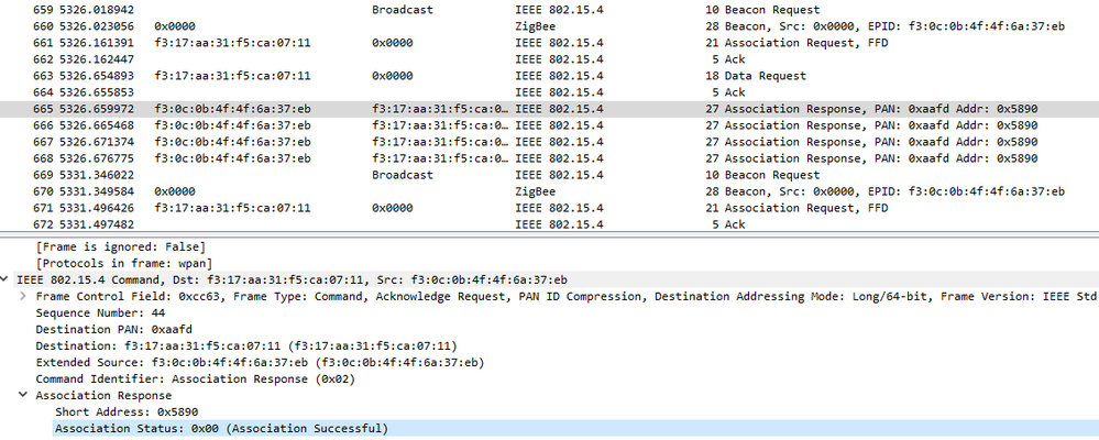

Currently I' facing some issues with communication. The MKW41Z512 device initializes communication, it receives beacon and then starts association procedure. But this procedure fails when coordinator sends association response (successful):

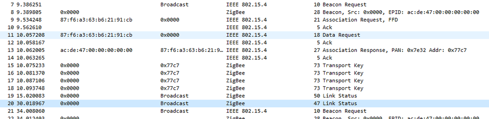

sometimes I see that communication goes further but it reach maximum a Transport Key transmission:

I also checked to connect the MKW41Z512 device to a MKW41Z512 - based coordinator. And in such setup everything works. I can see successful connection and communication. It seems like there are some issues during transmission data from  CC2520 to MKW41Z512.

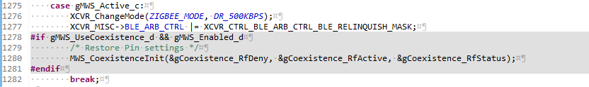

2. As I know, recommended bitrate fr 2.4G is 250 kbps for ZigBee, but I discovered that the PHY for MKW41Z512 sets 500 kbps as default value. I tried to use  250 kbps setup but in this case the MKW41Z512 device wasn't able to receive beacon from the CC2520 coordinator.
PhyPacketProcessor.c
PhyStateMashine.c:

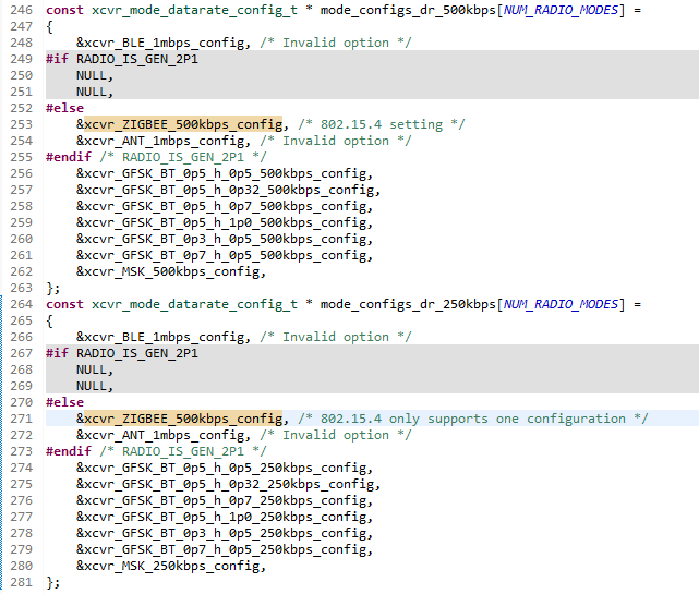

In addition to previous information I have discovered that no matter what bitrate is selected for ZigBee the same configuration is used and it is 500 kbps.
fsl_xcvr.c:
I will be grateful for any comments regarding this issue.

Hi Bogdan,
This is a documentation issue. Please accept our apologies.
However, the Zigbee Specification mentions the is 250 kbps for communication. The example shows that was set up by 500 kbps but the KW41 is working on 250 kbps.

Thank you for the reply. I also found information in MCU's datasheet that the bitrate is 250 kbps. On the other side a chip supports 250 kbps as well and it is the only option.

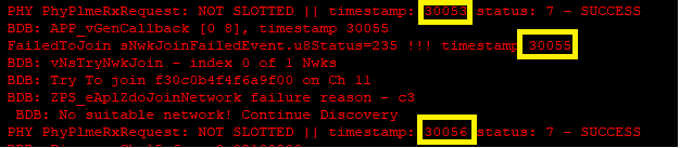

Unfortunately I haven't solved the issue yet. it seems like some timings issues. I added some debug print outs to a PHY layer and I see that ZigBee or MAC layer terminates communication too early:
I see just 2ms between switching to Rx mode in the PHY and notification that connection is not establishing from ZigBee.
At same time coordinator sends Association Response with larger delay (from 4 to 20 ms) since last ACK. And of course the PHY doesn't have chances to receive it.

As I see communication fails due to failure in certain packets receiving on the NXP MCU side. It doesn't receive Association Response packets from the coordinator side so it doesn't confirm such data with ACK. So, coordinator stops further transferring. And I see that MAC or ZigBee implementation on NXP MCU side reports that communication is not successful quite early, Packets from my coordinator hasn't reach NXP MCU at that time

The root cause was in ACK reply from the coordinator side (a reply on data request packet from end device side). It should contain frame pending bit set to "1" to indicate that coordinator will transfer association response packet. In my case the coordinator don't set this flag and the end device just ignores association response packet. Everything works after fixing the coordinator side.
BTW, I have discovered commented source code in the PHY layer (for example in the PhyStaeMashine.c). It looks like it wasn't checked/reviewed properly before releasing. I would recommend to  review it.
