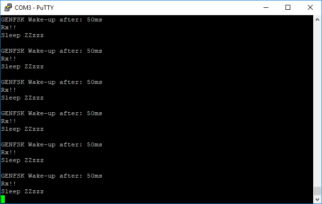

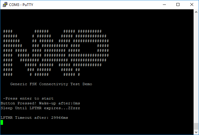

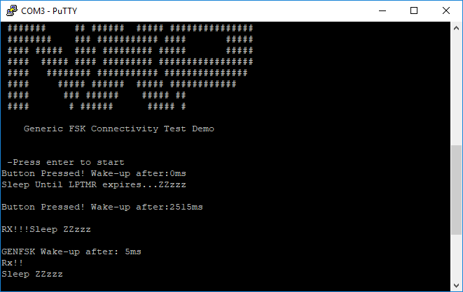

A simple test
To do an example we can modify the App_Thread to alternate between Rx event and DSM Event forever and logging the time which the device spent in deep sleep. The DSM timeout is 50ms, whilst the LPTMR timeout is 30s. The board used is the FRDMKW41Z configured in buck mode.
Declare a buffer to satisfy the GENFSK_StartRx signature, a variable in which store the amount of time spent in deep sleep and a list of states in which the app will be. Modify the main_task as follow :
static uint32_t timeAsleep;
typedef enum{
 idle_c,
 rx_c,
 dsm_c,
 dsm_over_c,
 lptmr_c,
 lptmr_over_c,
 button_pressed_c //FIX: log when a button is pressed
}apk_status_t;
static apk_status_t apk_st;
static uint8_t rx_buffer[100];

Modify the App_Thread as follow:
void App_Thread (uint32_t param)
 osaEventFlags_t mAppThreadEvtFlags = 0;
 timeAsleep=0;
 while(1)
 (void)OSA_EventWait(mAppThreadEvt, gCtEvtEventsAll_c, FALSE, osaWaitForever_c ,&mAppThreadEvtFlags);
 if(mAppThreadEvtFlags)
 if(mAppThreadEvtFlags&gCtEvtKBD_c)
 Serial_Print(mAppSerId,"\r\nButton Pressed! Wake-up after:",gAllowToBlock_d);

Modify the App_GenFskEventNotificationCallback as follow:
static void App_GenFskEventNotificationCallback(genfskEvent_t event,
 genfskEventStatus_t eventStatus)
 if(event & gGenfskTxEvent)
 mAppGenfskStatus = eventStatus;
 /*send event done*/
 OSA_EventSet(mAppThreadEvt, gCtEvtTxDone_c);
 if(event & gGenfskRxEvent)
 if(eventStatus == gGenfskTimeout)
 OSA_EventSet(mAppThreadEvt, gCtEvtSeqTimeout_c);
 else
 OSA_EventSet(mAppThreadEvt, gCtEvtRxFailed_c);
#if (cPWR_UsePowerDownMode)
 if(event & gGenfskWakeEvent )
 if(apk_st==dsm_c){
 PWR_DisallowDeviceToSleep(); //FIX: do not disallow if a button is pressed
 apk_st=dsm_over_c;
 OSA_EventSet(mAppThreadEvt, gCtEvtWakeUp_c);
 } else if(apk_st==lptmr_c){
 apk_st=lptmr_over_c;
 OSA_EventSet(mAppThreadEvt, gCtEvtTimerExpired_c);
#endif /* (cPWR_UsePowerDownMode) */
 /*not handling other events in this application*/
Connect to the terminal and start the application pressing the Button 1 (SW4). We will see this output, telling us that the wake-up happens after the DSM timeout specified into the code:
If the Button 2 (SW3) is pressed, a DSM timeout greater than the LPTMR will be set, and then the device will be woken-up through the LPTMR.
Now Press again Button 2, wait a couple of seconds, and then press the Button 1. You will see the LPTR timeout interrupted by the button pressure:
Hoping that this is the correct way to implement it, and that it will be useful for others.
G.
