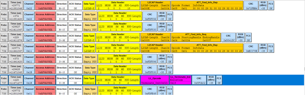

actually i have doubted the connection parameters request from the app(iphone/ android), once i have sniffered a log that
the app send the request, but have not found the accept message from slave. and then disconnected.
the above code segment is from BleConnManager_GapPeripheralEvent.
besides, there should be a problem in function BleConnManager_GapCentralEvent:
in the central role, if the gConnUpdateAlwaysAccept_d is set to 0 and the connection interval min = 6, then the result is false. the judgement of the value logic need to check.
