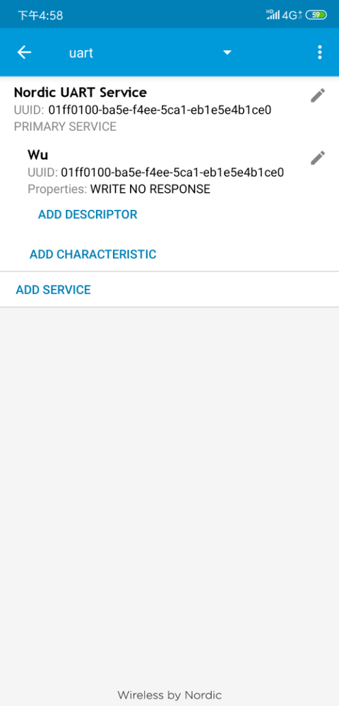

Hi Ziv,
You are using nrf connect app to connect wirelss uart app, right?
If yes, that is expected.
you can see the reason in the function void BleApp_StateMachineHandler(deviceId_t peerDeviceId, appEvent_t event) implement,
        case mAppExchangeMtu_c:
            if (event == mAppEvt_GattProcComplete_c)
                /* update stream length with minimum of maximum MTU's of connected devices */
                (void)Gatt_GetMtu(peerDeviceId, &tempMtu);
                tempMtu = gAttMaxWriteDataSize_d(tempMtu);
                mAppUartBufferSize = mAppUartBufferSize <= tempMtu ? mAppUartBufferSize : tempMtu;
                /* Moving to Service Discovery State*/
                maPeerInformation[peerDeviceId].appState = mAppServiceDisc_c;
                /* Start Service Discovery*/
                (void)BleServDisc_FindService(peerDeviceId,
                                              gBleUuidType128_c,
                                              temp.pUuidObj);
            else
                if (event == mAppEvt_GattProcError_c)
                    (void)Gap_Disconnect(peerDeviceId);
The board will start to find uart service from your cell phone after connect and exchange MTU, which means you need to add a wireless uart service with proper 128 bit UUID on your phone like attached picture.

Hi Jingsai,
very thanks. :smileyhappy:
i have searched the "Gap_Disconnect" and found the course. for i found the Iot toolbox (iphone version) is working fine, just others have this issue.

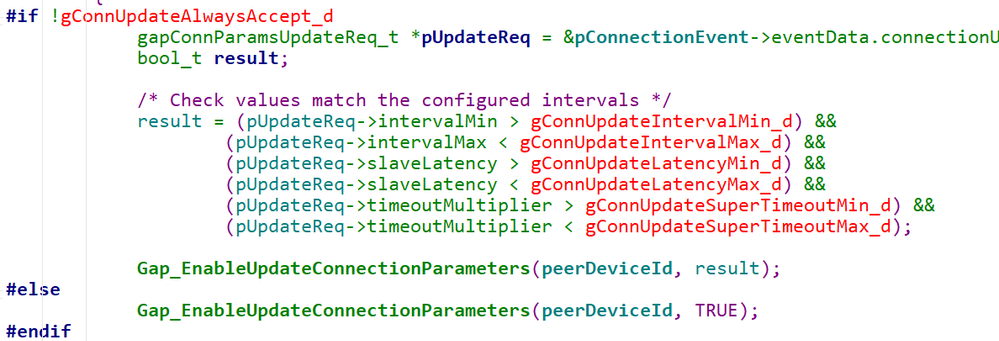

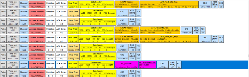

actually i have doubted the connection parameters request from the app(iphone/ android), once i have sniffered a log that
the app send the request, but have not found the accept message from slave. and then disconnected.
the above code segment is from BleConnManager_GapPeripheralEvent.
besides, there should be a problem in function BleConnManager_GapCentralEvent:
in the central role, if the gConnUpdateAlwaysAccept_d is set to 0 and the connection interval min = 6, then the result is false. the judgement of the value logic need to check.
