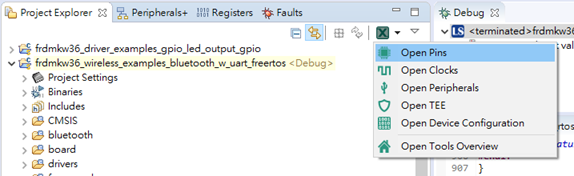

I want to use Pin config tool as follows:

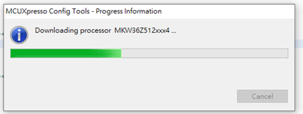

Step1: Select project, then click "Open Pins"
Step2: The download progress bar of MKW36Z512xxx4 appears

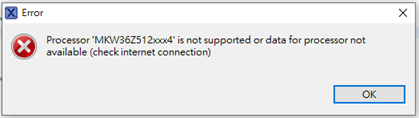

Step 3: The message that does not support MKW36Z512xxx4 appears, as follows:
I have checked that my network is connected, and I still get an error signal.
How can I enter the pin Config Tool?

In the tab, ConfigTools->Data Manager make sure the FRDM-KW36 data is cached and up-to-date. Another suggestion I have is to download the latest SDK version, v2.2.3 Welcome | MCUXpresso SDK Builder
Let me know if this is helpful, if you have more questions do not hesitate to ask me.
