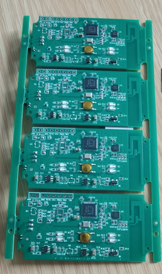

Hello, I use JN5169 to design a product, which has been mass produced many times. This time, there are a batch of jn5169, more than 1000 of which cannot be programed (programing with jn51xxprogrammer.exe). The chip number is JN5169 SBR234 ZSD5451. They chip supplier said that this batch was befort 2015. Is there any special requirements for programming  JN5169 which before 2015?
  I am looking forward to your reply, thank you.

yuchenglin
I bought the JN5169 SBR234 ZSD5451 from one of the local dealers,my schematic and my programming operation are absolutely right,because the replacement other JN5169 (which tail number is not ZSD5451)in the same board is programed sucessful.Can you check the JN5169 SBR234 ZSD545 is anything special about this chip?
Is the chip is otp? or it's programming port is disable? or this chip is fake? there is some image about my borad bellows

yuchenglin
I have more than 1000 pieces of JN5169 SBR234 ZSD5451 on my hands. and none of them  can be programed. the image above is the picture of the chip. so the problem is serious!!!I need your help, thank you!

mario_castaneda
It seems to be correct, but the UART programming process is the same.
Is it possible that you could share where you bought or what is the distributor that you asked for this device?
Mario

yuchenglin
The JN5169 where I bought  is Shenzhen meisixing Technology Co., Ltd.The seller  could not tell me the distributor. According the chip number can you check any problem?
9,344 Views
mario_castaneda
Hi @yuchenglin,
I looked into this company that provides the JN5169 Devices. The Shenzhen meisixing Technology Co., Ltd is not authorized to provide this product.
We do not encourage you to buy from a non-authorized distributor.
If you do so then you will not have any support from NXP. Even if they are not counterfeit. We cannot guarantee something we don't know how it was handled or the origin of the parts.
Sorry for any inconvenience that this may cause you.
