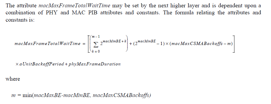

u16MaxTotalFrameTxTime is the time that the device will stay in RX waiting for a frame when it expects one, e.g. after a data request where the acknowledge has indicated that a frame is pending. The value should be determined from the values of minBE, maxBE and maxCSMAbackoffs using a slightly complicated formula that is in the 802.15.4 spec (for 802.15.4-2011 it is in section 6.4.3, but in any version just search for macMaxFrameTotalWaitTime).
