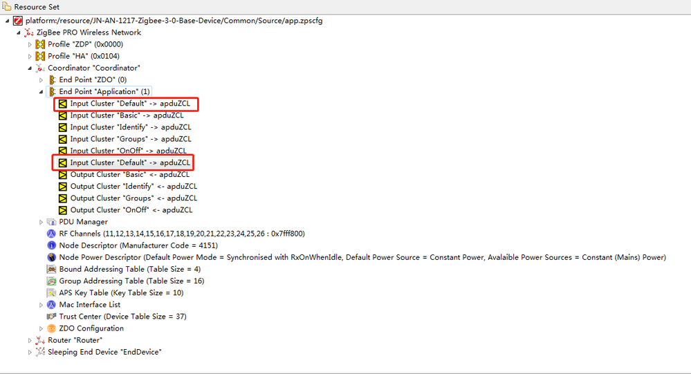

    In the app.zpscfg file of the project Zigbee-3-0-Base-Device, i discover that there have two 'default' input clusters and don't have any ‘default' output cluster, as below:
    Do you know the reason is that.

Thank you for your feedback, it seems to be a mistake in the configuration. In the meantime, you can create a new Output Cluster with the same properties as your Default Input Cluster and delete the second Default Input Cluster.
