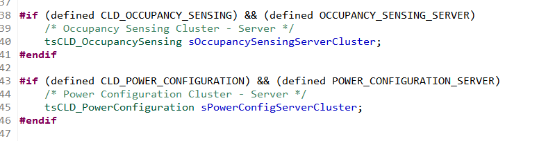

Working with the JN5169.I have added the cluster.Now the problem is how to actively report this voltage.

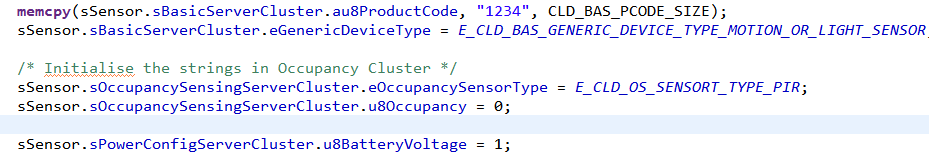

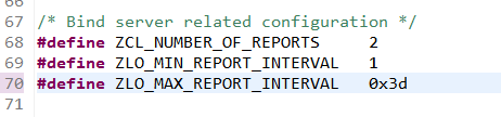

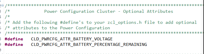

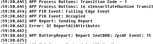

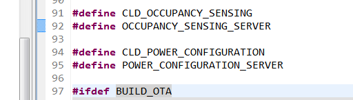

I want to report BatteryVoltage and Occupancy two Attributes on the routine JN-AN-1220,There is no problem with sOccupancy being reported, but BatteryVoltage cannot be reported

And did you add and configure the attributes correctly as stated in the B.2 Configuring Attribute Reporting

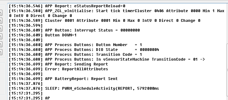

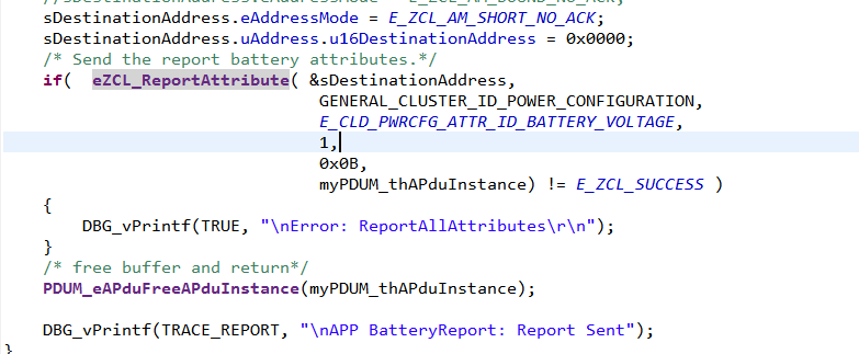

LChll
  • Returns the specified ZCL status code 32,Am I missing something?
