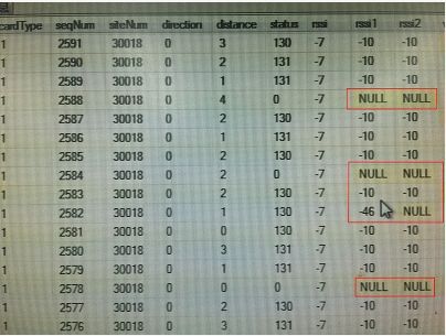

1. RSSI  do TOF on 25 channels, RSSI1 and RSSI2 send RSSI packets on channel 20.

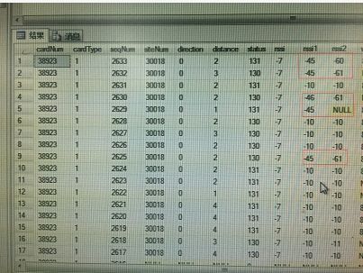

    Figure 1 Figure 2 is a close-up, occasional signal strength attenuation is particularly serious, and occasionally RSSI packet loss,
2.Figure 3 shows that large-area RSSI packet loss occurs at a distance of about 250m.
3.RSSI channel signal strength is always weaker than TOF channel signal strength
We don't know when this happened. The previous product did not have this situation and it needs to be solved.

Hi:
ok,The signal strength is not caused by changes in the external environment. Even if I put the two devices together, the signal strength value received by the Coordinator will jump or even be lost.
Maybe there is a problem with my code, let me check it again, and you have a routine to send wireless signals on a fixed channel. I can use sinffer to capture and view data. If so, please send me one. My email: [email protected], thank you very much

I will re-describe our problem:
          Existing equipment End-Device A, Coordinator 1, Coordinator 2, Coordinator 3.
         End-Device A broadcasts a signal frame received by Coordinator 1, Coordinator 2;Coordinator 1,Coordinator 2  respectively recording the signal strengths as rssi1, rssi2, then End-Device A switching channels with Coordinator 3 doing TOF recording signal strength Rssi.
         The current problems:
            1. End-Device A and Coordinator 3 communicate normally in the range of 400m. End-Device A and Coordinator 1, Coordinator 2 lost the wireless signal frame of End-Device A at around 200M..
             2. We found that the rssi signal strength is always stronger than the signal strength of rssi1, rssi2.
             3. The close-range test found that rssi1, rssi2 signal intensity will be abruptly attenuated, and occasionally signal loss will occur.
      I have been troubled by this problem for a long time, I hope you can provide support, thank you
