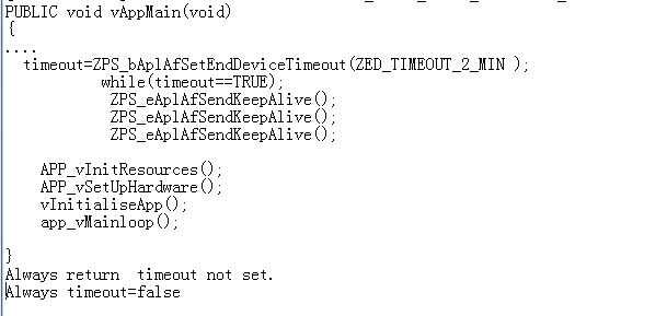

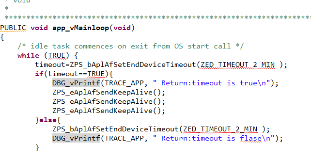

jun951753jun951
  • Can you configure it this way?
  • Or in the initialization function?
  • How do I use this function?
