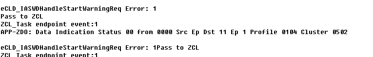

About IASWD device, there is data received and sent, but it cannot be executed into the callback function APP_ZCL_cbEndpointCallback E_ZCL_CBET_CLUSTER_CUSTOM:
  • Log displays when WD receives a command from CIE
How can I solve this problem?Thanks.

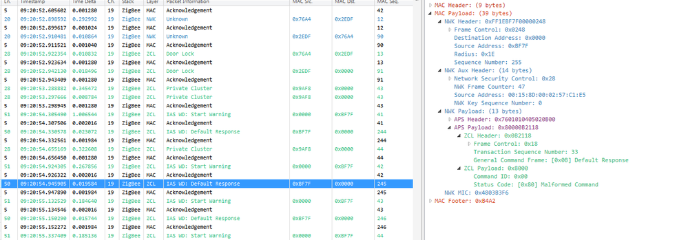

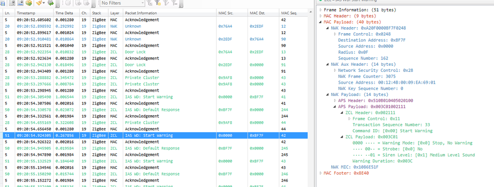

Hi Linklai,
Could you please provide the sniffer log?
Are you sending the data to the custom cluster?

Is sending to the IASWD.

Hi Linklai,
Did you look at the eCLD_IASWDCommandHandler function that is calling when the device receives an IAS command?
