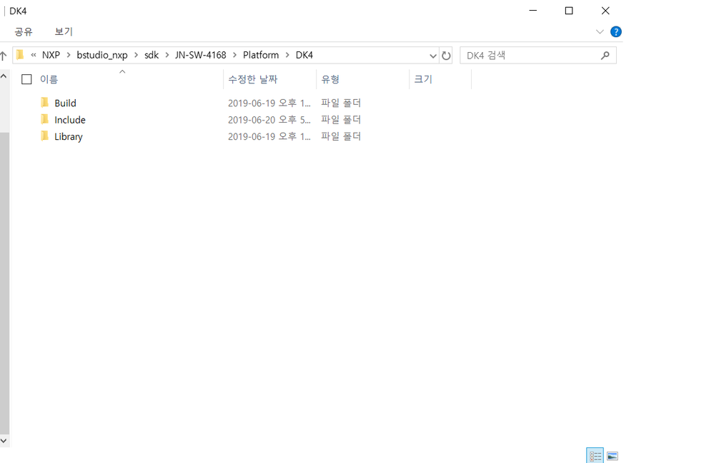

Another quesiton.
- C:\NXP\bstudio_nxp\sdk\JN-SW-4168\Platform\DK4
     DK4 folder has Build,Include,Library folder.
If I changed the include file, how to build it and how to adjust it?
I need your help.

choisanghyun
Hi Mario.
I used JN-SW-4168, it does not have Source directory.
Do I need to update or used another SDK?
3,197 Views
mario_castaneda
Hi Choi,
I'm sorry, you could try the JN-AN-1218 Light Bulb example and the Zigbee 3.0 Stack JN-SW-4170.
Sorry for any inconvenience.
Mario
