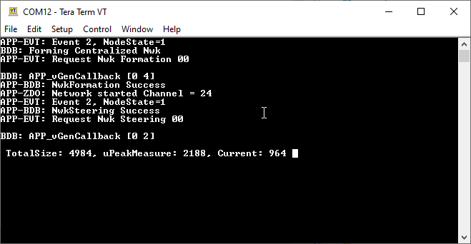

mario_castaneda
Hi Nha Dang,
I tried by my side and it works as expected.
Please see the modifications that I did. Look at the MC STACK_MEASURE comments
1. I added the StackMeasure.c/.h files into the common folders.
2. Makefile.
# commands options
# enable optional commands as required per applicaion.
#NETWORK_RECOVERY       ?= 0
#[MC STACK_MEASURE]
STACK_MEASURE          = 1
#[MC STACK_MEASURE]
ifeq ($(STACK_MEASURE), 1)
CFLAGS += -DSTACK_MEASURE
endif
#[MC STACK_MEASURE]
APPSRC += StackMeasure.c
endif
 3.  Add the next code in the app_serial_commands.c
//[MC STACK_MEASURE]
#ifdef STACK_MEASURE
#include "StackMeasure.h"
#endif
PRIVATE void vProcessCommand(void)
    else if (0 == stricmp((char*)token, "measure"))
        tsStackInfo    sStackInfo;
        vGetStackMeasure( &sStackInfo );
        DBG_vPrintf ( TRUE, "\r\n TotalSize: %d, uPeakMeasure: %d, Current: %d ",
                                                sStackInfo.u32TotalSize,
                                                sStackInfo.u32PeakMeasure,
                                                sStackInfo.u32CurrentMeasure );
#endif
4. app_start.c
#endif
PUBLIC void vAppMain(void)
#if (JENNIC_CHIP_FAMILY == JN516x)
    /* Initialise the stack overflow exception to trigger if the end of the
     * stack is reached. See the linker command file to adjust the allocated
     * stack size. */
    vAHI_SetStackOverflow(TRUE, (uint32)&_stack_low_water_mark);
#endif
    vInitStackMeasure ( );
#endif
Mario
