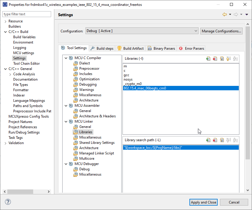

Hi Pawel,
The issue is because the example is selecting a different lib file that doesn't allow a periodic beacon.
Please look at the configuration and the changes that I did.
 * 802.15.4 MAC configuration
#define gMacFeatureSet_d gMacFeatureSet_06BEGTSM0_d //gMacFeatureSet_06M0_d [MC]
You have to add the lib802.15.4_mac_06begts_cm0.a lib file, you could copy from the SDK
"KW41SDK\middleware\wireless\ieee_802_15_4_5.3.8\mac\lib\lib802.15.4_mac_06begts_cm0.a"
Also, we have to add this lib in the linker file into the properties.
Mario
