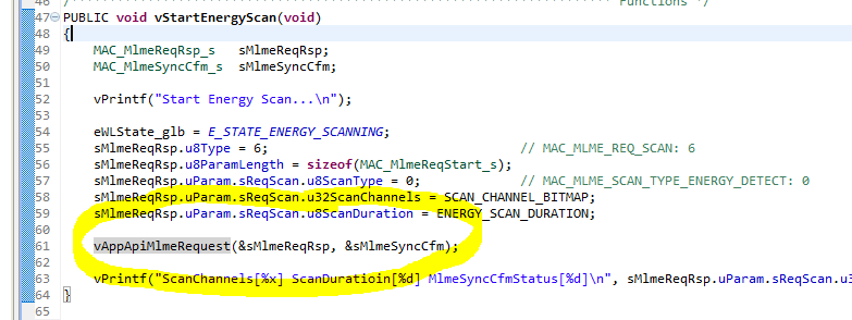

I want to use JN-SW-4163.
I tried to use sample program Jn-AN-1174. But there is not much information to follow it.
Anyway, I had a test that is doing Energy Scan.
But Compiler said cannot find a Liabrary that may be used for "vAppApiMlmeRequest(&sMlmeReqRsp, &sMlmeSyncCfm)".
This is makefile.
How to setup this?

Hi Hynchul Kang, I hope you're doing well!
I tried to replicate the error you're having, but had no issues building the project. Could you please take a look at this document detailing common BeyondStudio IDE errors, erasing your project and re-importing it as the document describes?
Please let me know if you still have issues.
