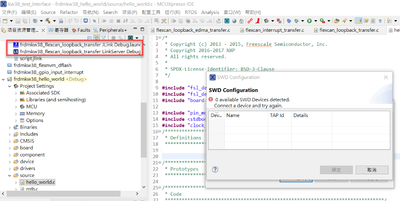

I am using FRDM-KW38,
MCUXpresso IDE v11.8.0.

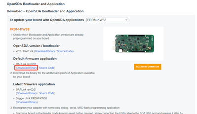

Press reset button before connected USB port to PC.
After connected to PC, KW38 is in "DAPLINKBOOT",
Paste download file.bin from "https://www.nxp.com/design/design-center/software/sensor-toolbox/opensda-serial-and-debug-adapter:OP..."

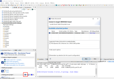

Now, I Debug with LinkServer probes,
The window always show "SWD Configuration" 0 available SWD Devices detected.
Connect a device and try again.
Please help me to debug kw38.
Thanks.

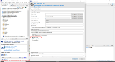

Your FRDM might be in Low Power mode. Could you try to do a mass-erase? By using an "unlock kinetis" command in J-Link Commander, or a mass erase command through MCUXpresso, which works as well.

Adam_Ho
Hi Ricardo,
I use MCUXpresso to do mass erase.
but there is "Target Connection Fail" show in console log. 
 I attach the erase log on below.

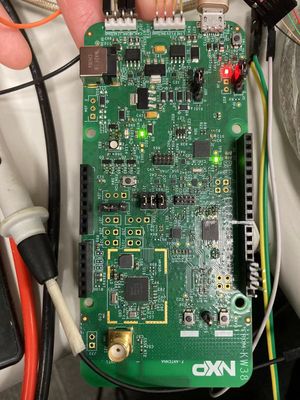

Could you find any clue on development board?

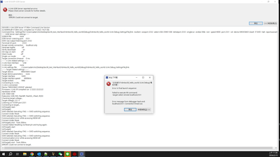

Adam_Ho
Hi Ricardo,
I try program with J-Link.
But it still not work.
I leave the  program error log as below.
Do you have any idea?
Thanks.
Adam
