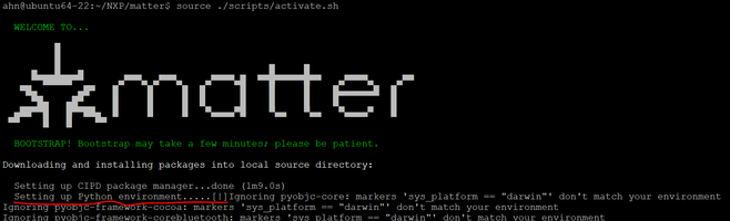

I have an IOTZTB-DK006 from NXP.
I'm currently looking at the DOC(K32W0X1-MATTER-QSG_Rev1.0(Getting started with K32W0x1 in Matter).pdf) and trying to build an environment.
I used virtual Box to create an image of ubuntu64-22.04.3.
I have read and followed the documentation, but I am not able to progress in the python Part as shown below.
I've searched the internet and installed several pip packages, but I'm still unable to resolve the issue.
What's the problem?
error: subprocess-exited-with-error
× Getting requirements to build wheel did not run successfully.
│ exit code: 1
╰─> See above for output.
note: This error originates from a subprocess, and is likely not a problem with pip.
Getting requirements to build wheel: finished with status 'error'
│ exit code: 1
['/home/ahn/NXP/matter/.environment/pigweed-venv/bin/python', '-m', 'pip', 'install', '--log', '/home/ahn/NXP/matter/.environment/pigweed-venv/pip-requirements.log', '--requirement=/home/ahn/NXP/matter/scripts/requirements.txt', '--constraint=/home/ahn/NXP/matter/scripts/constraints.txt'] {'stdout': <_io.TextIOWrapper name=3 mode='w+' encoding='UTF-8'>, 'stderr': -2}
None

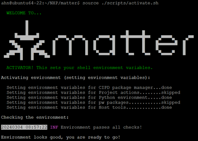

   Start build environment by running the activate script:
$ source ./scripts/activate.sh
ubuntu64-22:~/NXP/matter$ git branch

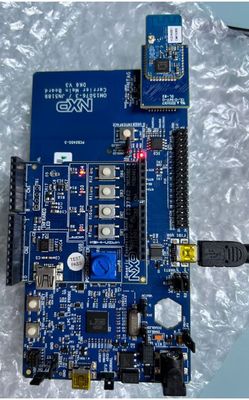

I successfully built the lighting-app and contact-sensor-app for Matter.
and I flashed the binary I built, but K32W061 board doesn't work.
1. Is there something wrong with the Build Procedure below? check plz..
2. Can you share a pre-built image for Matters? ("K32W061 + OM15082")
    I want 2 binarys for K32W061. (chip-k32w0x-light-example.bin , chip-k32w0x-contact-example.bin)
    I just want to flash the binary to check if the board working well.
"Build Procedure"
-https://github.com/NXP/matter/blob/v1.2.0.1-tag-nxp/examples/lighting-app/nxp/k32w/k32w0/README.md
-https://github.com/NXP/matter/blob/v1.2.0.1-tag-nxp/examples/contact-sensor-app/nxp/k32w/k32w0/README.md
-K32W0X1-MATTER-QSG_Rev1.0(Getting started with K32W0x1 in Matter).pdf
(I referred to link and DOC. I just wrote down the main points below.)
a. git clone https://github.com/NXPmicro/matter/
b. git branch --list
c. git pull
d. git submodule update --init
e. source ./scripts/activate.sh
f. west init -l manifest --mf west.yml
g. west update
h. export NXP_K32W0_SDK_ROOT=~/NXP/SDK_2_6_13_K32W061DK6/
i. gn gen out/debug --args="k32w0_sdk_root=\"${NXP_K32W0_SDK_ROOT}\" chip_with_OM15082=1 chip_with_ot_cli=0 is_debug=false chip_crypto=\"platform\" chip_with_se05x=0 chip_pw_tokenizer_logging=true"
j. ninja -C out/debug
k. $NXP_K32W0_SDK_ROOT/tools/imagetool/sign_images.sh out/debug/
l. Connecting the board, Flashing the application using DK6Programmer.
m. DK6Programmer.exe -V 5 -P 1000000 -s COM5 -e Flash
n. DK6Programmer.exe -V 2 -s COM5 -P 1000000 -Y -p FLASH@0x00=k32w061dk6_ssbl.bin
k32w061dk6_ssbl.bin(SSBL project using MCUXpresso, compiled with the PDM_EXT_FLASH)
o. DK6Programmer.exe -V 5 -s COM5 -P 1000000 -w image_dir_0=0000000010000000
p. DK6Programmer.exe -V 5 -s COM5 -P 1000000 -w image_dir_1=00400000C9040101
q. DK6Programmer.exe -V 2 -s COM5 -P 1000000 -Y -p FLASH@0x4000=chip-k32w0x-light-example.bin
-> I have tried flashing the binaries "chip-k32w0x-light-example.bin and chip-k32w0x-contact-example.bin" respectively, but board doesn't work.

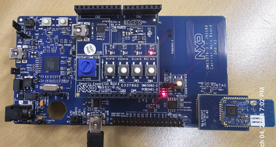

seah
I tried the instructions from matter/examples/lighting-app/nxp/k32w/k32w0 at v1.2.0.1-tag-nxp · NXP/matter (github.com), and successfully built chip-k32w0x-light-example.bin.
I then flashed the DK6 board with command
C:\nxp\DK6Programmer> ./DK6Programmer.exe -s COM10 -p chip-k32w0x-light-example.bin
but the board UI LED does not correspond to the README file, i.e. no blinking, as below
Please advise

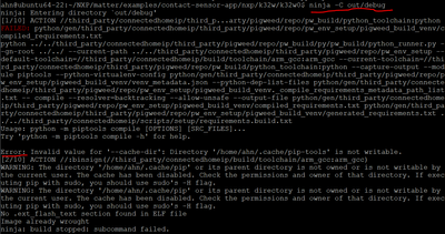

Mason-Ahn
I did it on the latest v1.2.0.1.3 you mentioned.
https://github.com/NXP/matter/blob/v1.2.0.1.3/examples/lighting-app/nxp/k32w/k32w0/README.md
-> I built it, and verified the Lighting APP UI behaviour on the K32W061 board.
https://github.com/NXP/matter/blob/v1.2.0.1.3/examples/contact-sensor-app/nxp/k32w/k32w0/README.md
-> I followed the same procedure as lighting-app above.
However, I encountered the following issue during the build.
If you look at the "/home/ahn/.cache/pip-tools" folder permissions mentioned above, it looks no problem.
Now "contact-sensor-app" is the problem. T.T
9,668 Views
Ricardo_Zamora
I was not able to reproduce your issue. Both applications can be compiled correctly from my side.
I would recommend updating your packages.
Ricardo
