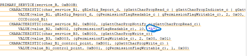

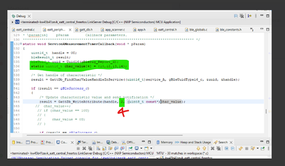

we are trying KW45 wireless example EATT freertos example and we are trying to modify data in the functiuon ServiceAMeasurementTimerCallback() but we are getting issue  with whatever data we are writing to database which is not reflecting in  central device, we are getting initialized data in gatt_db.h . screenshots are attached .  we are just getting initialized value (gatt_db.h) but its not updating with the data we are writing to database.
as per screenshot we are trying to write data of array  but in central we are getting 0x41 i,e A data and rest 9 bytes are 0.image.pngimage.pngimage (1).pngimage (1).png

in ServiceBMeasurementTimerCallback()
bleUuid_t uuid = Uuid16(gBleSig_Report_d);  changed to bleUuid_t uuid = Uuid16(0xB002);  because we are  checking for char_service_B2
static uint16_t char_value = 0U;  changed to  static uint16_t char_value = 12U;
and even we tried with same  UUID : bleUuid_t uuid = Uuid16(gBleSig_Report_d);   and just changed   changed to  static uint16_t char_value = 12U;
same issue just we are getting data which is initialized

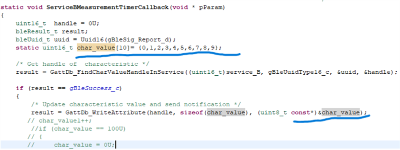

we tried to do changes in peripheral by updating  new service and also tried to use old custom service to send bulk data.
example: Eatt_peripheral freertos we specifically used this since its sending multiple packets. we are searching for example in which we can send bulk data and multiple packets.
1. we tried sending different 2 bytes  of data from eatt_peripheral  and we are checking in NRF connect but we are not getting any changed data.
2. so we tried with 2 KW45 boards one for central and another peripheral . in this if we change data which is writing to database is reflecting  in central but when we try for bulk data or array of data even after doing changes in below section :
1.we changed size of data required 10 bytes, using 0xB002 service B2
2.
these modifications we did. please check and assist we are not able to receive this in central
