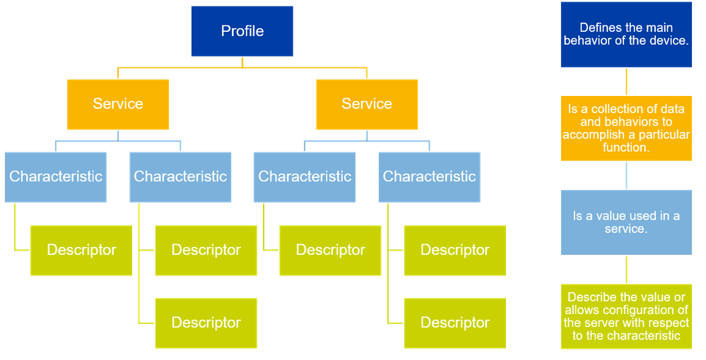

 GATT Database establishes a hierarchy to organize attributes. These are the Profile, Service, Characteristic and Descriptor. Profiles are high level definitions that define how services can be used to enable an application and Services are collections of characteristics. Descriptors defined attributes that describe a characteristic value.

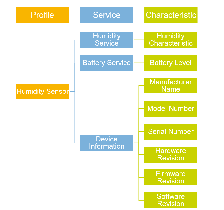

GATT Database
The Humidity Sensor is going to have the GATT Server, because is going to be the device that has all the information for the GATT Client.
On the Temperature Sensor demo have the Battery Service and Device Information, so you only have to change the Temperature Service to Humidity Service

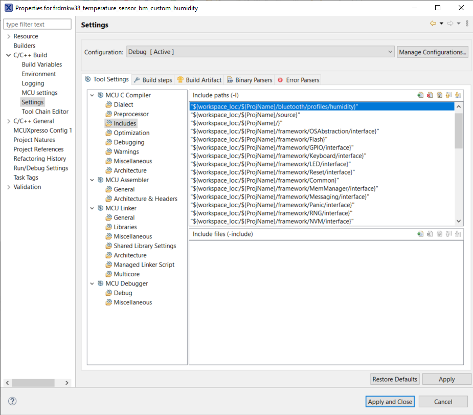

After that, create a folder humidity in the next path ${workspace_loc:/${ProjName}/bluetooth/profiles. Found the temperature folder, copy the temperature_service.c and paste inside of the humidity folder with another name (humidity_service.c). Then go back and look for the interface folder, copy temperature_interface.h and change the name (humidity_interface.h) in the same path.
You need to include the path of the created folder. Project properties>C/C+ Build>Settings>Tool Settings>MCU C Compiler>Includes:

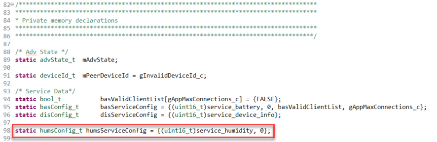

First, we need to declare the humidity service:
static humsConfig_t humsServiceConfig = {(uint16_t)service_humidity, 0};

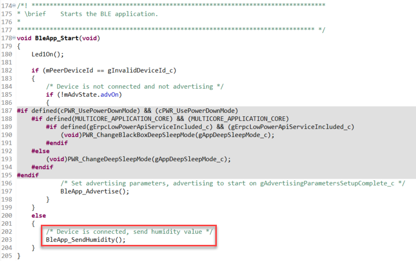

BleApp_Start
You need to modify this line:
/* Device is connected, send humidity value */
BleApp_SendHumidity();

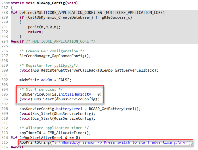

BleApp_Config

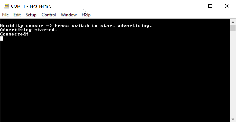

You need to start the Humidity Service, and to modify the PrintString line:
humsServiceConfig.initialHumidity = 0;
(void)Hums_Start(&humsServiceConfig);
AppPrintString("\r\nHumidity sensor -> Press switch to start advertising.\r\n");

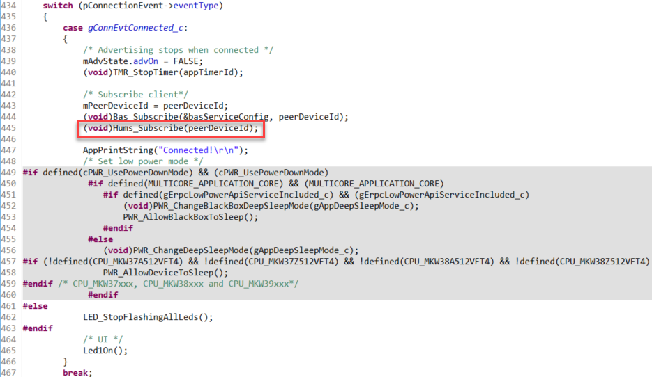

gConnEvtConnected_c
(void)Hums_Subscribe(peerDeviceId);

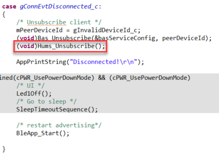

gConnEvtDisconnected_c
(void)Hums_Unsubscribe();

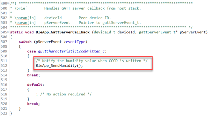

BleApp_GattServerCallback
/* Notify the humidity value when CCCD is written */

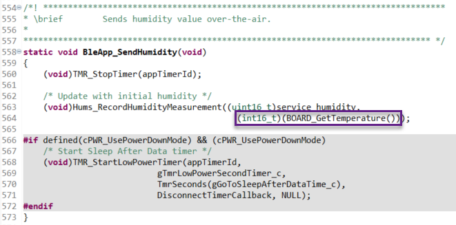

BleApp_SendHumidity
And, we need to add this function:
static void BleApp_SendHumidity(void)
    (void)TMR_StopTimer(appTimerId);
    /* Update with initial humidity */
    (void)Hums_RecordHumidityMeasurement((uint16_t)service_humidity,
                                           (int16_t)(BOARD_GetTemperature()));

In this example, the Record Humidity uses the BOARD_GetTemperature, to use the example without any external sensor and to be able to see a change in the collector, but, in this section would be a GetHumidity function.

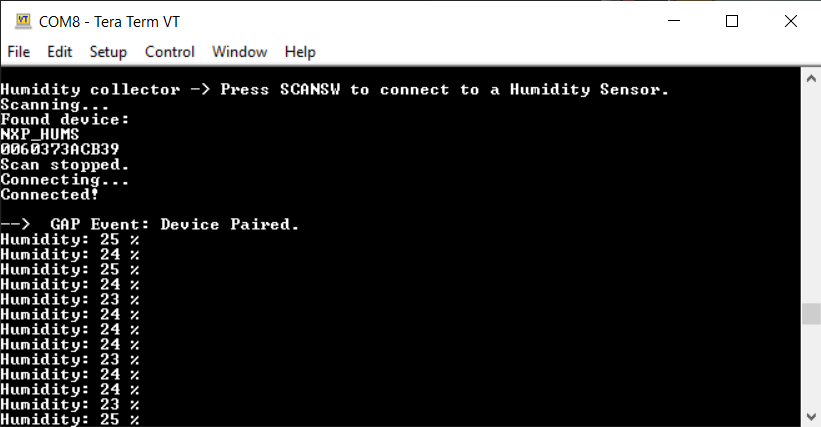

The Humidity Collector is going to have the GATT client; this is the device that will receive all information from  the GATT server.
Demo provided in this post works like the Temperature Collector. When the Collector enables the notifications from the sensor, received notifications will be printed in the serial terminal.

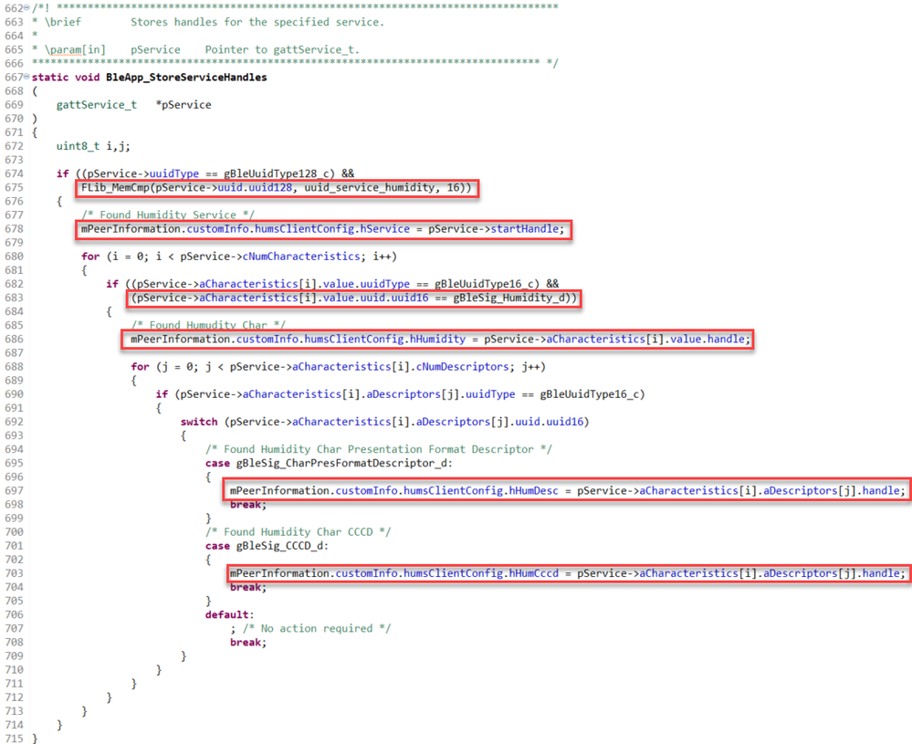

BleApp_StoreServiceHandles
static void BleApp_StoreServiceHandles
    gattService_t   *pService
    uint8_t i,j;
    if ((pService->uuidType == gBleUuidType128_c) &&
        FLib_MemCmp(pService->uuid.uuid128, uuid_service_humidity, 16))
        /* Found Humidity Service */
        mPeerInformation.customInfo.humsClientConfig.hService = pService->startHandle;
        for (i = 0; i < pService->cNumCharacteristics; i++)
            if ((pService->aCharacteristics[i].value.uuidType == gBleUuidType16_c) &&
                (pService->aCharacteristics[i].value.uuid.uuid16 == gBleSig_Humidity_d))
                /* Found Humudity Char */
            	mPeerInformation.customInfo.humsClientConfig.hHumidity = pService->aCharacteristics[i].value.handle;
                for (j = 0; j < pService->aCharacteristics[i].cNumDescriptors; j++)
                    if (pService->aCharacteristics[i].aDescriptors[j].uuidType == gBleUuidType16_c)
                        switch (pService->aCharacteristics[i].aDescriptors[j].uuid.uuid16)
                            /* Found Humidity Char Presentation Format Descriptor */
                            case gBleSig_CharPresFormatDescriptor_d:
                                mPeerInformation.customInfo.humsClientConfig.hHumDesc = pService->aCharacteristics[i].aDescriptors[j].handle;
                                break;
                            /* Found Humidity Char CCCD */
                            case gBleSig_CCCD_d:
                                mPeerInformation.customInfo.humsClientConfig.hHumCccd = pService->aCharacteristics[i].aDescriptors[j].handle;
                                break;
                            default:
                                ; /* No action required */
                                break;

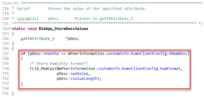

BleApp_StoreDescValues
    if (pDesc->handle == mPeerInformation.customInfo.humsClientConfig.hHumDesc)
        /* Store Humidity format*/
        FLib_MemCpy(&mPeerInformation.customInfo.humsClientConfig.humFormat,
                    pDesc->paValue,
                    pDesc->valueLength);

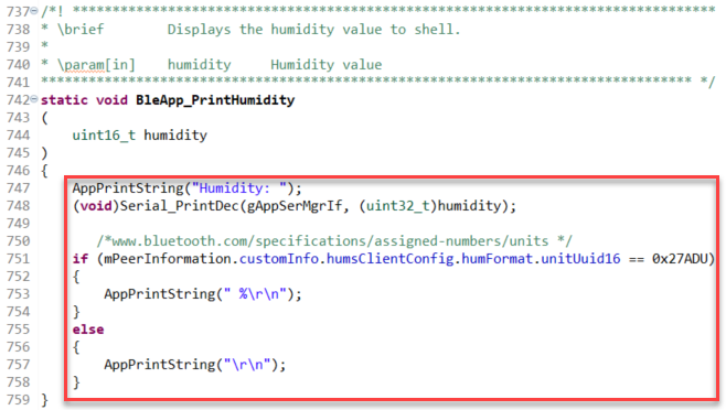

BleApp_PrintHumidity
/*www.bluetooth.com/specifications/assigned-numbers/units */
if (mPeerInformation.customInfo.humsClientConfig.humFormat.unitUuid16 == 0x27ADU)
    AppPrintString(" %\r\n");
else
    AppPrintString("\r\n");

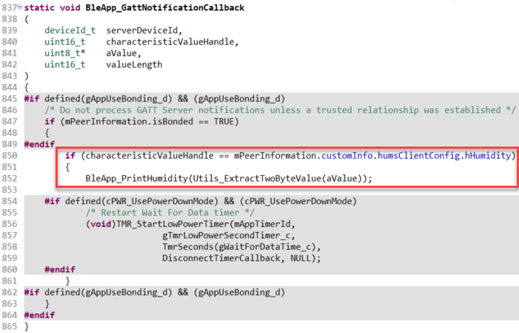

BleApp_GattNotificationCallback
if (characteristicValueHandle == mPeerInformation.customInfo.humsClientConfig.hHumidity)
    BleApp_PrintHumidity(Utils_ExtractTwoByteValue(aValue));

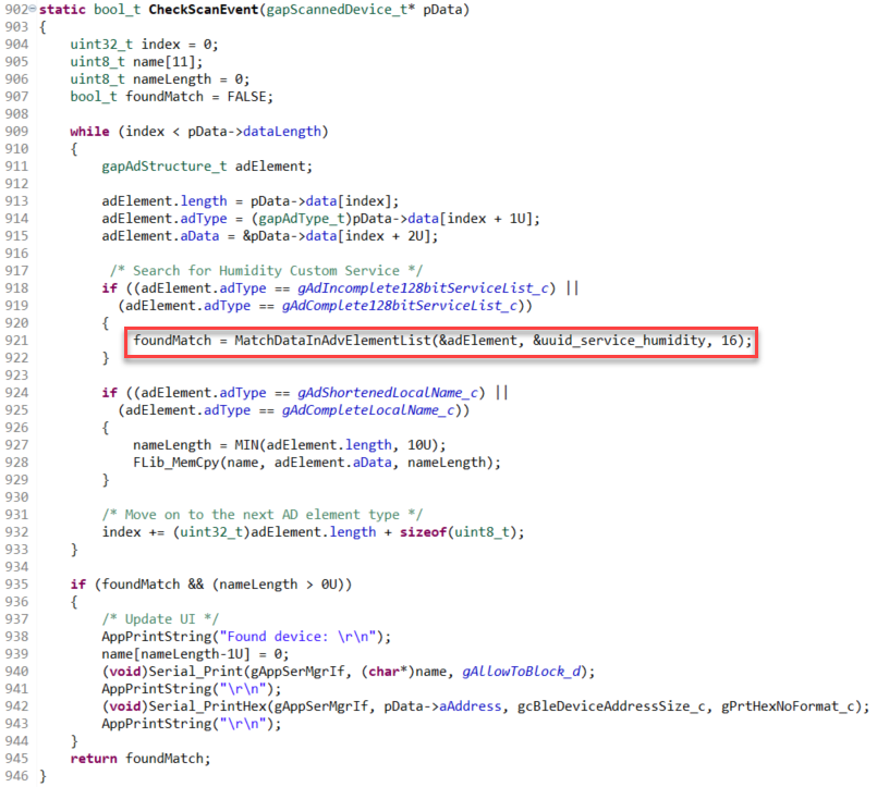

 CheckScanEvent
foundMatch = MatchDataInAdvElementList(&adElement, &uuid_service_humidity, 16);

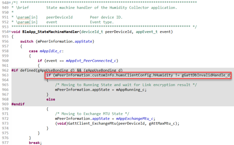

BleApp_StateMachineHandler
mAppIdle_c

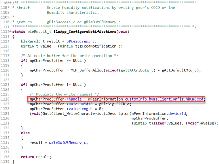

if (mPeerInformation.customInfo.humsClientConfig.hHumidity != gGattDbInvalidHandle_d)

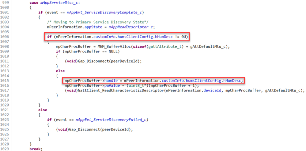

mAppServiceDisc_c
if (mPeerInformation.customInfo.humsClientConfig.hHumDesc != 0U)
mpCharProcBuffer->handle = mPeerInformation.customInfo.humsClientConfig.hHumDesc;

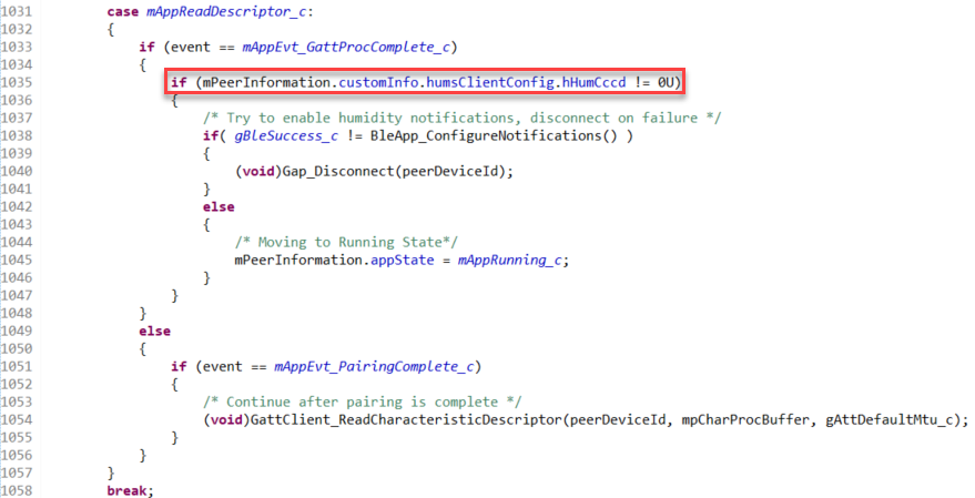

mAppReadDescriptor_c
if (mPeerInformation.customInfo.humsClientConfig.hHumCccd != 0U)
BleApp_ConfigureNotifications
mpCharProcBuffer->handle = mPeerInformation.customInfo.humsClientConfig.hHumCccd;
Demonstration
Now, after connection, every time that you press the SW3 on KW38 Humidity Sensor is going to send the value to KW38 Humidity Collector.
