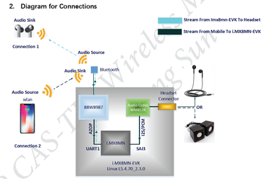

       The article will describe how to configure A2DP audio application Based On NXP platform and WIFI/BT chipset step by step. Users can easily make her A2DP audio based on NXP WIFI module work normally by following steps in the article.
  1. Environment for the validation
  • Hardware Platform
       i.MX8MN-EVK
  • Software
  • Kernel version: L5.4.70_2.3.0
  • rootfs : imx-image-multimedia
  • WiFi module
       AW-CM358SM: NXP 88W8987 chipset
