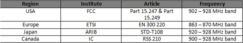

Freescale's MRB-KW019032 is certificated to operate in the following SubGHz ISM bands:
The firmware used to certificate our KW products is the Radio Utility or the Connectivity Test, it allows the user in changing some RF parameters needed to pass the certification process.
