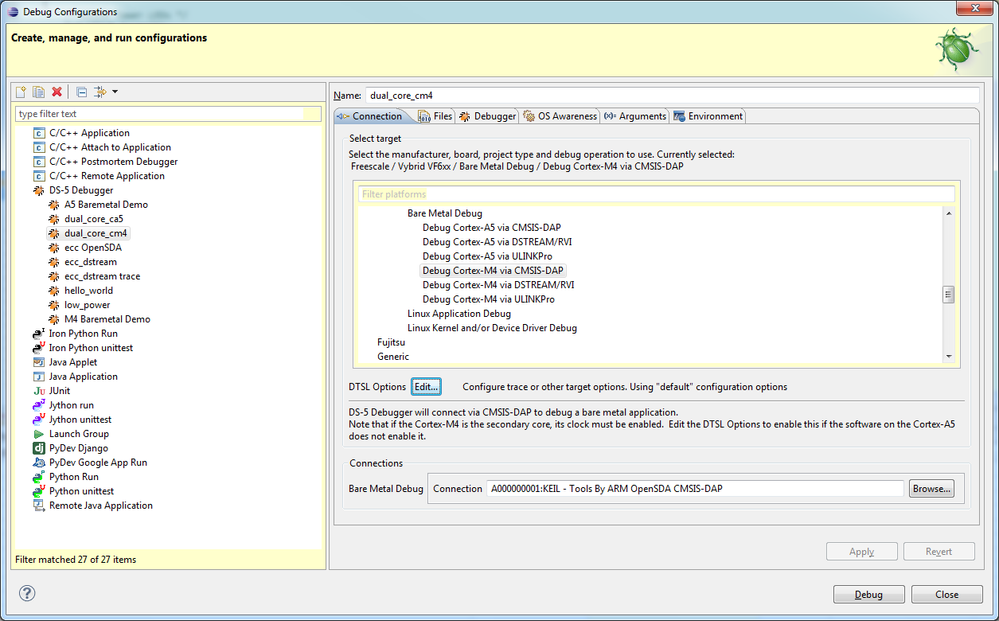

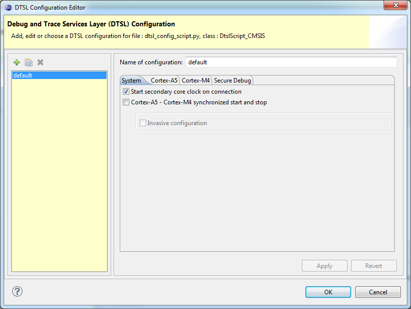

You need two debug configurations: one for CA5 and one for CM4:
Click at button DTSL and check Start secondary core .....
Then you should connect to both cores separately.
/Jiri

All option you need clock for secondary core. In default configuration where Cortex-A5 is primary core the clock for Cortex-M4 is not enabled after reset. So you can :
  • enable CM4 clock from debugger (DTSL options). In this case you can immediately start second debug connection for Cortex-M4
  • or you can enable it from Cortex-A5 code. In this can you can start Cortex-M4 debug session after Cortex-A5 core run "start_m4" routine where clock is enabled
you can see a video for it https://www.youtube.com/watch?feature=player_embedded&v=djExDHsBa5w (in newest DS-5 the connection configuration is little bit different)

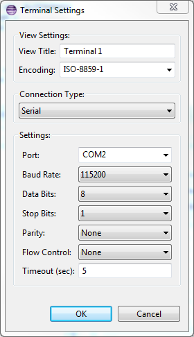

Unfortunately I can even not check the terminal output of printf(). I tried to use the terminal of DS-5 with following settings, but get no output, neither from M4 nor A5
(even though changing the UART_PORT to UART2 according to Rev G Tower Board Changes)

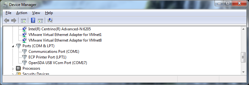

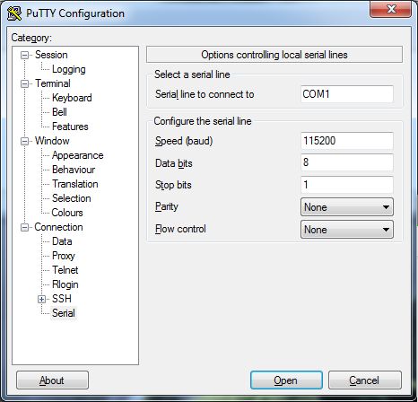

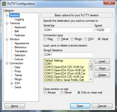

please check which serial channel is available on your machine i device manager:
then use puTTy, TerraTerm, Hercules or any other application and set communication parameters to 115200 b/s, no parity, 1 stop bit and no flow control.
