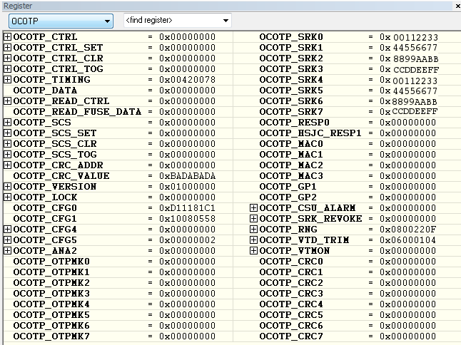

I am having trouble getting HAB authentication to work on the TWR-VF65GS10 and am wondering what I am missing or what I can try to do to get it to work. The compiler I am using is IAR Embedded Workbench.
In my situation, I have 2 tower boards: one in open state that I am using for reference and the other in closed state with the SRK values generated by the cst 2.3.1 package written to the OCOTP_SRK fuses. I can still debug using JTAG on the closed board.
I created a program blink.bin (attached along with linker file sram_iar_a5.icf) that will boot from the SD card and then continuously blink the LEDs on the tower board based on the example in \Freescale\Freescale_MQX_4_2\mqx\examples\bootloader_vybrid. I booted blink.bin from the SD card on the open board and confirmed that it worked but after following the signing steps on blink.bin I cannot get the signed image to boot from the SD card on the closed board.
So far, I have been using AN4581 as a guide.
From there I generated the PKI tree and SRK table.
I programmed the fuses and verified with the debugger (OCOTP_SRK#) that they were actually programmed.
(Do I have the order and endianess correct in the example below?)

Next, I closed the board by programming Bank 0, Word 6, Byte 0 to 0x02 (verified with OCOTP_CFG5).

It appears my locked board is preproduction as referenced here https://community.nxp.com/thread/314356. All the OTPMK values were 0 so I burned in random values to the OTPMK fuses.
The closed board still won't boot though.
