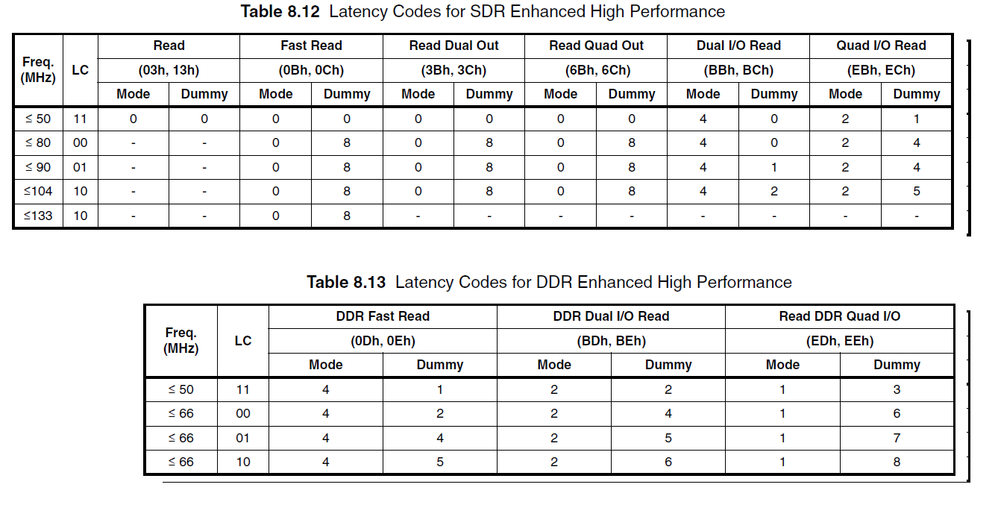

Good eye! But what about address and command phases of instruction? It is still output/write, which table title talks about "QuadSPI Output/Write timing (xDR mode)". I would love better 1/Tck limit for reads. If DDR with learning works up to 108MHz on Vybrid Tower Board, I'd love 80 and even 66MHz.
BTW I was testing it in parallel mode.
  •    I also noticed that I was only using 2 dummy cycles in DDR x4 mode. I increased that to 4 and DDR x4 started working.
You should not guess these figures but check your memory datasheets. But it is not easy to deduce reading and scrolling memory datasheets several times. For Spansion S25FL128S the numbers of dummy cycles are specified in four tables:
Two tables for "high performance" and two tables for "enhanced performance". The first or the second depends on part code, either ordering with enhanced feature or without it, or reading part information from the chip. LC in the table is configurable thing. You may reprogram register inside the memory chip(s) for one or another LC setting and thus for more or less dummy cycles. But you can't take any LC setting but should follow Freq. requirements in these tables. Also, keeping in mind DLP feature, only settings with more than 4 cycles will work with DLP. So you need 5, 6,.. dummy cycles. It was not clear for me are S25's on Tower board enhanced high performance or not, fortunately ED/EE commands have the same dummy cycles in both chip variants. Default LC=00 setting is already fine for DLP. Of course it is a wonder DDR reading was working up to 108MHz, while memory tops at 66.

Yes, DLP should help setting DDRSMP sample point automatically, but
1) are you sure your memory chip is transmitting DLP? S25FLxxx have configurable latency code setting. Not all settings have enough dummy clocks to allow DLP transfer. There's also DLP pattern setting, are you sure it is something useful like 0x34 (should toggle on clock edges, as well in the middle between two clock edges) and not zero or 0xFF?
2) did you check Vybrid QSPI status bits, DLPFF? Once QuadSPI module executes DATA_LEARN sequence (what you show in your picture) it should set DLPFF bit in case of problem determining DDRSMP.
(Some) Smaller QSPI memories don't have DDR instructions so I decided to go better availability, code works well with bigger and smaller memories, so no DDR.

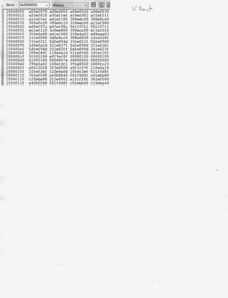

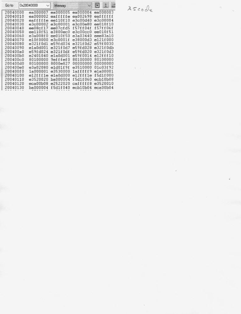

Ran into an interesting phenomenon recently. As you know I am trying to write a "loader" program that gets loaded by the Vybrid ROM on reset. The loader program (executing from OCRAM) initializes the clocks and DDR controller, and using an optimized QSPI driver, copies my main program (setting in QSPI flash) into DDR memory. This gets around using the DCD to set up either the QSPI, DDR, or clocks.
In doing this, I've written a QSPI driver based on the one in u-boot. One of the problems I'm having is that it produces different results depending on whether I use it with my loader app (which is bare metal), or use it with my main app (which runs under MQX). I don't use the QSPI driver internal to MQX because of some problems it has. The biggest issue is that when I use my driver under MQX, and look at the data using IAR's examine memory function, it appears the way it should be. When I use the exact same driver in my bare metal app, the data is all messed up (nibbles out of order). If I halt my loader program and examine the flash memory (0x20000000+), the nibbles are out of order. When I halt my main app and examine the same area, it looks fine. I even checked the endian bit, but it's the same with both apps (little endian). I examined memory with J-Flash which is independent of code, and it shows the flash to be correct. There is no difference in the driver between the two apps. The only difference I can see is the memory copy function used in the driver. In the bare metal app, memory copy (as supplied by IAR) is done using load/store multiple instructions. Under MQX, memory copy (as supplied by Freescale) is done using the Neon coprocessor.
The IAR  debugger has an examine memory function. The thing that's really crazy is that when I use this function to examine flash memory (0x2000000+) while running the two apps (loader and main apps) the results are different. Nothing is being reprogrammed (of course I have to initialize the QSPI controller, but I checked, and the registers are set up the same way in both apps).
I can program my loader program to manually manipulate the nibbles to make them correct, but that takes way too much time. Any ideas?

kef2
Senior Contributor V
Do you really see nibbles swapped and not bytes? Are you using QSPI DDR mode? If you had 4-pins mode + DDR, then perhaps bad phase delay could produce >>4 or <<4 shift and memory view similar to nibbles swapped?
I don't know what else could make nibbles swapped. You can't nibble swap even in parallel QUAD mode, for this Vybrid pin muxes should allow pins swapping QSPI_IOn_A with QSPI_IOn_B, which is not available.
Well I tried for my curiosity all QSPI modes in the past, 1x, 2x, 4x +DDR / noDDR. All worked well. Bad things of course may happen if you fail setting up QSPI lookup table (QSPI commands) properly, but I have no idea if and how these may lead to nibble swap.
Ah, do you see these problems when debugging from IDE or when booting from QSPI? If problems only while booting, then this may indicate some part of your initialization assumes reset default state, something more is needed to reinitialize after boot ROM. (DS-5 debugger helped there. After QSPI was programmed, I was unchecking run until _main option, loading only debug symbols, clicking reset in debugger, setting up HW breakpoint at program entry point, clicking continue. This made boot ROM code executed and stopped at my program entry point. This allowed to figure all troubles.)
Edward

Table 7-22 indicates that on bootup, the fastest speed of the QSPI controller in DDR mode is 18 MHz. I don’t know why it’s limited to that. Have you found otherwise? For speed reasons, it would be nice to run in DDR mode, but 18 MHz is a non-starter. My guess is that changing the processor clock speed while
 It is 18MHz (least possible?) because Vybrid doesn’t know in advance how cheap your QSPI memory is and whether it supports 2x 4x or DDR and even doesn't know what read commands your memory chip is using in specific 2x/4x/etc mode. All these fast settings are read from configuration struct at bottom 1k of your QSPI memory.

Thanks for your comments. BTW: I’m using the Vybrid RM 10/2016. I’m getting close to figuring this out. I think I’m going to go with a separate” bare metal” load routine. The routine will configure the A5 clock to 396 MHz (to match the DDR), set up the DDR memory, and copy my app from QSPI to 0x80000000 via DDR x4, then jump to it. My main app is already set to load the M4 code from QSPI. This makes it easier to update my apps as I can put everything on sector boundaries for easy erasing. I’ll skip using the DCD, and have the load routine do everything. I know the IVT and DCD are big endian, is the QSPI Configuration block( at location 0 in flash) and BOOT DATA also big endian?

Do you know if all of the “stuff” from flash location 0 through the app code (in my case the load routine) can be copied into 0x3F00_0000, or does it have to start at 0x3F04_0000?

So now I’m trying to write the load routine app that will have 3 functions: do whatever it takes to get the A5 core running (not sure what all that is yet) including setting the clocks up for 396 MHz operation, initializing the DDR and QSPI controllers, and copying my real app into DDR memory. The load routine is the one that will be loaded by the boot ROM (together with the QSPI configuration parameter , IVT,…) into 0x3F04_0000. I know how to set up the clocks and controllers. What else is needed to get the A5 core going well enough to do the above? I don’t need interrupts. I’m using MQX on the A5 which will set everything else up when it starts running.Have you done anything like this before?

..like this? - Booting from QSPI - yes. Using DDR RAM from bare metal - no, OCRAM was enough for me for bare metal. Vybrid with DDR RAM and Linux - yes.
Did you see and try Vybrid Sample Code(VSC)? https://www.nxp.com/webapp/sps/download/license.jsp?colCode=VYBRID_SAMPLE_CODE_SBCH
If they didn't change anything, to start with boot form QSPI you need two projects, hello_world and quadspi_load. You need to set hello_world make configuration to QuadSPI_XIP. Quadspi_load project includes code image from hello_world (hello_world_output.c) and programs it to QSPI. Once programmed you need to reconfigure Tower board jumpers to boot from QSPI to make it working XIP.
For non-XIP mode  you need to clone hello_world QuadSPI_XIP target, then 1) edit (new) scatter file from QuadSPI_XIP to replace all 0x20xxx addresses to 0x3Fxxx addresses. RAM section address should be moved to stay above the code section. 2) Edit quadspi_boot.c, you need to replace in bood_data FLASH_BASE(0x20000000) with your selected 0x3Fxxxx address, also change load size accordingly to make system boot copying conf, ivt, dcd, boot data and all required code to RAM.
