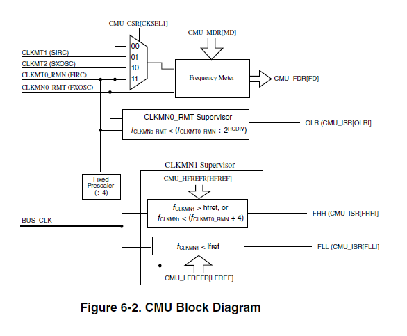

  • we configured the MPU to reset it when FOSC is less than 40MHz - register SRC_SICR[CMU_OLR]. It works as expected
I think you refer to CMU_OLR bit description on page 850 VFxxx RM Rev.0 10/2016:
  • Configures CMU event of FOSC frequency less than 40 Mhz
This must be wrong and rudiment from older manual perhaps for different chip. First of all oscillator clock is 24MHz on Toradex, so how would it help comparing to 40MHz? It is also contrary to Figure 6-2. CMU Block Diagram:
As you may see OLRI compares internal 24MHz oscillator (FIRC) to external oscillator (FXOSC), which is 24MHz for Toradex module. 2^RCDIV is 1,2,3 or 4. So in the best case you can compare external FXOSC (24MHz) to FIRC/2 (12MHz). (BTW did you enable clock monitor? OLRI, FHHI and FLLI don’t work without enabling CMU). 24 vs 12MHz is a big frequency step! Since all apps operate at high PLL clocks, also PLLs with removed source clock usually operate for a while until going totally into the weeds, I think you should compare bus clock to internal/external oscillator. Comparison borders should be set quite narrow. As soon PLL and bus clock drifts, reset using SRC_SIRC or fire interrupt on failure to switch in ISR immediately back to internal oscillator and try to recover.
