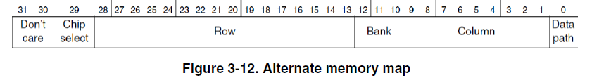

I'd like to know DDR memory addressing of Vybrid, because we have to check memory contents is correct or not.
I saw the DDr memory addressing map like below.
Does this means when data write/read to memory, address move to Column=>Bank=>Row.
So, data write/read column[0:9]->1k/bank0, then change bank 0 to 1 and column0-1k/bank1 after bank 7, then row0->1.
Is this correct?
I suppose sequential access means Column=>Row=>Bank, but Vybrid seems different.

  DRAM address mapping for Vybrid is correct. You may also look at
section 10.1.6.1 (Address Mapping) of VFxxx Controller Reference Manual,
Rev. 0, 10/2016.
