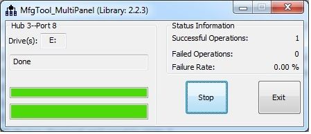

BlueJay
Hi Alejandro,
perhaps I misunderstand you, or there is a missunderstanding.
I never tried to boot uboot from SD.
As I described at my initial posting, I want to use the Mfg_tool (Rel. 1.0.1) to download a SW binary file with a simply blinking LED into 4SPI flash device which is connected at 4SPI1 interface of Vybrid VF65xx.
With following settings, Mfg_tool doesn´t hang anymore, performed with status "done" and green bar,
HW:
BOOT_MODE[1:0] = 01 (serial downloader)
ucl2.xml:
<LIST name="vybrid-qspi-led" desc="Boot Vybrid FW">
   <CMD state="BootStrap" type="boot" body="BootStrap" file="u-boot.vybrid">Loading U-boot</CMD>
   <CMD state="BootStrap" type="jump"> Jumping to OS image. </CMD>
   <CMD state="Updater" type="push" body="qspiinit dev=1">Initializing QSPI</CMD>
   <CMD state="Updater" type="push" body="pipeqspi addr=0x50000000" file="files/FNLD_A.bin">Sending and writing QSPI Led Sample</CMD>
   <CMD state="Updater" type="push" body="$ !">Done</CMD>
    </LIST>
Tai-Phan
6,996 Views
BlueJay
MfgTool.log with the last 12 log.-entries:
