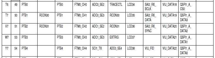

BlueJay
Hi Alejandro,
today I was trying to evaluate the Mfg_tool with the TWR-VF65GS10 again. As I could see u-boot SW also outputs logging data via SCI1 interface:
PTB4 (SCI1_TX), PTB5 (SCI1_RX)
With HTerm at J8 (RS232) logging data can be recorded.
On our target HW the 4SPI flash device is connected at QSPI1 interface of Vybrid VF6xx:
As you can see, QSPI1_A_DATA0 is at PTB4, so there is a conflict with PTB4 of Vybrid VF6xx.
If my assumption is correct Mfg_tool cannot support booting 4SPI flash at QSPI1 interface of Vybrid VF6xx.
Can you confirm this issue ?
Tai-Phan
8,826 Views
alejandrolozan1
As I see you should be able to boot from QSPI1, I mean that the BootROM code should be able to get the uboot image from QSPI memory. But after U-boot is runnig, this configures the SCI_Tx pin after that you won't be able to communicate with the QSPI memory.
Alejandro

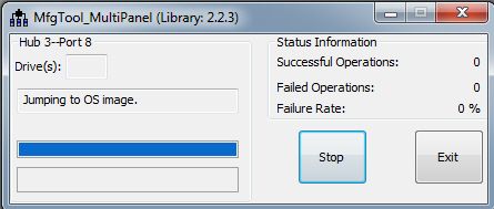

BlueJay
Hi Alejandro,
firstable thank you very much for the attached file.
Today I tried the u-boot.imx immediately, I copied the new u-boot.imx into ..\Mfgtools-Rel-1.0.1\Profiles\Vybrid TO 1.1 Update\OS Firmware.
After execution the Mfg_Tool is hanging at:
ucl2.xml:
     <LIST name="vybrid-qspi-led" desc="Boot Vybrid FW">
     <CMD state="BootStrap" type="boot" body="BootStrap" file="u-boot.imx">Loading U-boot</CMD>
     <CMD state="BootStrap" type="jump">Jumping to OS image. </CMD>
     <CMD state="Updater" type="push" body="qspiinit dev=1">Initializing QSPI</CMD>
     <CMD state="Updater" type="push" body="ubootcmd qspierase 0x50000000">Erase u-boot environment sector</CMD>
     <CMD state="Updater" type="push" body="pipeqspi" file="files/FNLD_A.bin">Sending and writing QSPI Led Sample</CMD>
     <CMD state="Updater" type="push" body="$ !">Done</CMD>
     </LIST>

Please tell me what I could still try ? And just tell me if you need any additional details I could provide for you.

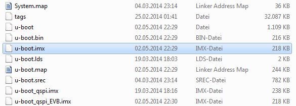

BlueJay
Hi Alejandro,
today I closely take a look at the files you provided: ..\u-boot
All files are from 2014 !!! Is it the wrong folder I look for ? Something is quite strange ! Please would you check it e. g. correct attached file ?
Tai-Phan
8,824 Views

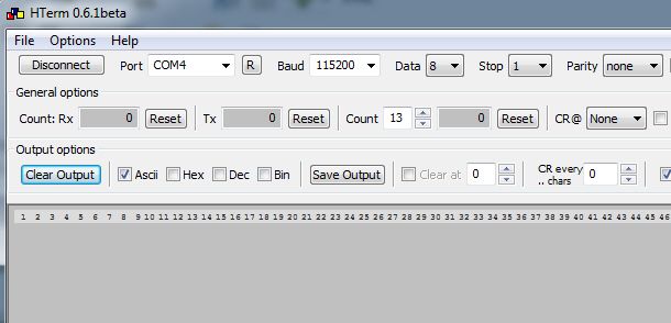

BlueJay
Hi Alejandro,
...sure, I can try to get the output from UART0 interface !
Firstable I ensure that our HW and PC tool work well at UART0 interface:
The I start the Mfg_Tool with the uboot.imx provided by you: there is no data received by HTerm => see also "video.zip" !
Tai-Phan

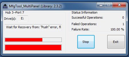

BlueJay
Hi Alejandro,
with the new U-boot I could get partial sucsess with Mfg-Tool.
For the 1st trying I created a blinking SW with suitable boot header for Vybrid: all work fine !
Size of the binary file is about 9k.
Then I tried to flash a test SW with bigger size, about 233k into device, but it was not successfully done by Mfg-Tool (please refer to attached file):
Enclosed you can find beside the logging files, also the binary file for testing.
