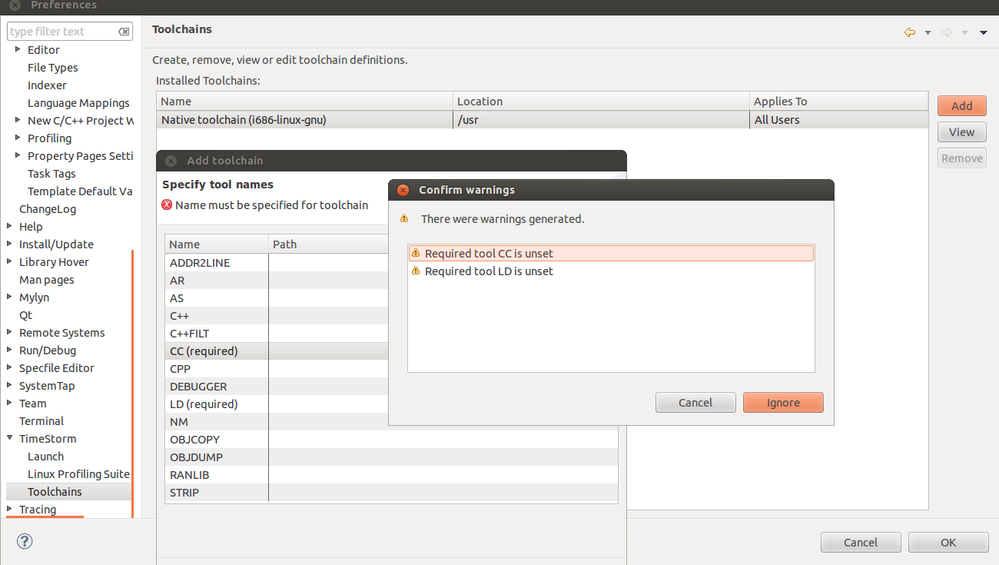

Dear Sir/Madam,
I am new for Linux Timestorm development environment for Vybrid. I set all factory tools and timestorm in ubuntu 12.04, and able to run and debug simple hello project. But When I debug the code, I could see the intel 8086 assembler instruction sets.
How can I set the project cross compile, link, debug parameters for Vybrid?
Thanks and best regards.
Mehmet Ali İpin

MehmetAliIpin
Contributor V
Dear Timesys,
I read “How To Create and Debug Hello World in TimeStorm” document with “timestorm-manual-4.4.1.pdf”.
When I open the Preferences->Timestorm->Toolchains, I see “Native toolChain i686”. When I add I see the warning message "reqired tool CC is un set ", which I added screenShot.
What Should I do?
Best regards.
Mehmet Ali

timesyssupport
Senior Contributor II
Hello Mehmet,
I would recommend following the prerequisites on the following link:
https://linuxlink.timesys.com/docs/how_to_create_and_debug_hello_world_in_timestorm
The first point, installing the SDK Installer from your Factory build output, is required in order to register a toolchain with TimeStorm. Once you do this, you can restart TimeStorm, and the cross-compile toolchain from the SDK will be listed in the Toolchains dialog box above and be available for use in compiling/debugging a TimeStorm project.
Thanks, and let me know if you have any questions.
Timesys Support
