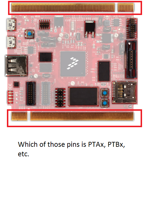

Thank you for the documents, but on p99 what we find (if I am not mistaken) is the pin layout of the processor at the center of the board, and not of the golden pins on the side of the board.
I know the pin functions are indicated on the schematics but what I am trying to find out is : which of the side golden pin is PTA6 for instance.
I'm sorry if I am not being very clear and thanks again for helping.

What you are looking for is on Page 8 of the TWR-VF65GS10_SCH.pdf schematic.
J17A is the Primary Elevator connector.
J17B is the Secondary Elevator connector.
Each Elevator connector signal also lists the Vybrid pin function. For instance, J17A, B19 is Elevator Signal ETH_TXD1_1 and is also Vybrid signal PTC6. These are all listed on that page.
Another example, J17A, A40 is Elevator signal PWM0 and Vybrid signal PTB0.
The Elevator signal names are listed inside the symbol representing J17A and the Vybrid signal/pin function/names are listed on the 'wires' coming out of the J17A symbol.
It is easy to find Vybrid signal names - you can use Adobe Reader's search function. Search for "PTA6" and Adobe Reader will take you directly to every instance of that string and highlight it in the document. In this example, if you searched for "PTA6" you would find that this Vybrid signal is listed three times in the schematic and is not routed to either elevator, and is connected to resistor R21.
If you searched for for "PTC30", Adobe Reader will tell you that it is connected to Primary elevator B29, resistor R20, and the potentiometer, R60.

Ok thank you that is exactly what I needed.
Just to be sure, for the primary connector, the A pins are the one on the top side of the board (side with the USB connector), the B pins are the pins on the bottom side, and for the secondary, the C pin are on the top side and the D pin on the bottom side?

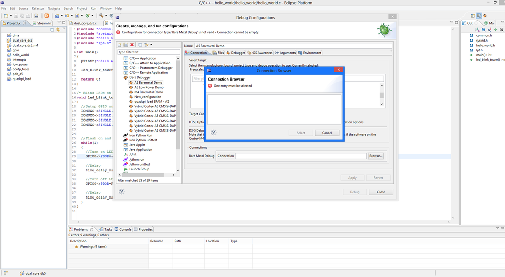

I am using DS-5 Ecplise and I followed the getting started guide, up to the point page 9,
"Right click on the A5 project and navigate to Debug As->Debug Configurations…, select the proper connection, and hit the Debug button to establish a connection with the Tower board."
The Debug button remained unclickable because no connection were detected (the board was plugged in my computer and the orange LED was on).

Looks like you're running DS-5 on Windows. I'm using DS-5 on Ubuntu. Things should be very similar if not identical.
This is where you need to determine which hardware debugging method you will use. I'm using the CMSIS-DAP, which is just a USB cable connected to J3 on the CPU board. I think this is what you want to do, too. I think that orange/yellow LED should NOT be on and it certainly should not be flashing. If it is, then the board is not configured correctly for CMSIS-DAP debugging. It is probably configured to act as a UART-to-USB port. On my board, the LED is not lit.
In any case, you need to configure the board for CMSIS-DAP debugging and that means you have to load new firmware on it. For that, you need the firmware and instructions on how to do it.
You need to find "TWR-VF65GS10-QSP.zip". Go to Freescale's main webpage and put that into the search box there. It should take you to a download page. It contains a nice little PDF guide, "Vybrid DS-5 Getting Started Guide". Follow that guide and it will take you through most of what you need to do (I think you are already reading that). It has a lot of good information. That zip file also has the firmware you need for the Freescale K20 CPU (which is on the bottom of the board). In the "OpenSDA" folder of that zip file, you'll find another PDF file that will give you some info about what this is all about. Unfortunately, it doesn't tell you what to do. For that, you need to download the OpenSDA User's Guide at:
http://cache.freescale.com/files/32bit/doc/user_guide/OPENSDAUG.pdf
Just one thing you should know. In that .zip file, you are interested in two of those firmware files: CMSIS_DAP.S19 and VIRTUAL_SERIAL_PORT.SDA
The first firmware file is what you will need to load onto the K20 to be able to program the Vybrid and debug it.
The second firmware file is what you will need to turn the K20 into a serial port (via USB) to your computer. However, in order to do this, you'll need the elevators as well as the TWR-SER2 module. There are other ways to view the serial port if you didn't buy the entire tower system.
Note that you cannot have the CMSIS-DAP debugger *and* the serial-to-usb functionality at the same time. It's one or the other. It got to be such a pain for me to switch back and forth, I just connected some wires from the board to an RS-232 transceiver and left the CMSIS-DAP firmware loaded in the K20 full-time.
Once you get that K20 configured as the CMSIS-DAP debugger, you will configure DS-5 to use that connection. In the "Debug Configurations" window, you will hit "Browse..." under "Connections". If you have selected "CMSIS-DAP" under "Target Connections", it should see the board. you just select it. At this point you are ready to debug and the "Debug" button should not be greyed out any more.

I followed the guide you provided, entered the BOOTLOADER mode and copied the CMSIS_DAP.S19 file onto the board. I then unplugged the USB cable, but when I plug it back in, the board does not seem to be detected anymore (I do not see it in my Computer directory).

You have now configured the K20 to be a CMSIS-DAP debugger. It will no longer show up as an MSD (disk drive). Now you will be able to use DS-5/IAR/CodeWarrior to download your programs and debug them.
You do not need to have the elevators or the other boards to program the CPU board.
It seems you need to pay closer attention to the document OPENSDAUG.pdf, which I linked to earlier.

Regarding your first question: Almost, but not quite. If you hold the board so that you are looking at the CPU, the USB connectors are on your left:
Look at the upper right of the board just under the gold fingers - you will find the word "PRIMARY". If you look at the very right-most gold finger, you will see the designation, "B1" in tiny, tiny white silkscreen.
Look at the bottom edge of the topside of the board, below the words "TWR-VF65GS10", you will see the word "SECONDARY". At the very bottom left of the board, just above the left-most gold finger, you'll see the designation "D1" in really tiny white silkscreen.
Turn the board over and you'll find the "A1", "C1", "PRIMARY", and "SECONDARY" designations as well.
