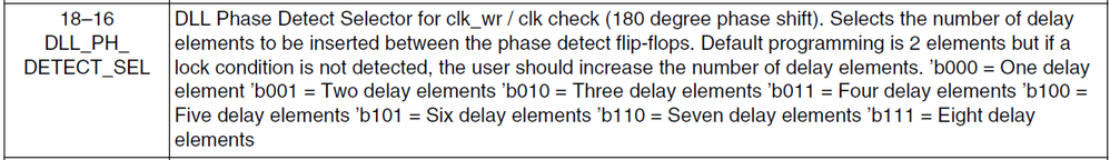

3. In PHY03,19,35 is undocumented field bits 22:20 which sets Phase_detect_sel. It is number of delay elements between lock detectors. Default is b000 which is one element. Please increase it from 2 elements 0b001 up to 5 elements 0b100
Other bits sets Master DLL:
     0x __X_____ 22:20 sets number delay elements between lock detectors.
     0x ___X____ 19:16 sets number if LOCK indications to consider as LOCKED.
     0x ____XX__ 15-8 sets time to DLL to lock. It can help to lock - bigger value = more time.
     0x ______XX 7:0 sets DLL starting point.
We set 0x0001012a into PHY03/19/35 where starting point of DLL = 2A, Increment = 1,  number of indications =1, number of delay element = 1 (0b000).
When number of delay element is increased, then number of indication have to be increased.
Please change it up to 0x0042012A
This should help to DLLs lock, stay steady and CKE is asserted.

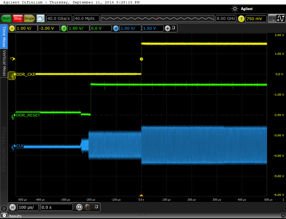

CKE signal is asserted during SDRAM controller initiation. Please check DDR_CR80[INT_STAT] and CCM_CCSR[DDRC_CLK_SEL] prior to access SDRAM.
DLL lock is possible to read in DDRMC_PHY11/12, DDRMC_PHY27/28 and DDRMC_PHY43/44
you should see this:
/Jiri

Hello Norihiro-san,
CKE is controlled from SDRAM controller based on controller mode.
Clock to the controller have to be selected and UN-gated prior to setting any register ( CCM_CCSR[DDRC_CLK_SEL], CCM_CCGR6[CG110] )
Once the controller is set up (CR and PHY registers) then you can start the controller in DDR_CR000[START]. Phy is initiated. Memory is reset. Master DLL have to lock. Then clock to the memory is enabled using CKE. Memory is initiated.
Once all is initiated INT_STAT = 1 ( DDRMC_CR80 bit [8] )
So init sequence is waiting for master DLL to lock.
You can check each slice DLL status in DDRMC_PHY11/12, DDRMC_PHY27/28 and DDRMC_PHY43/44.

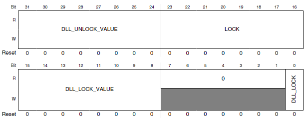

DDRMC_PHY11::Bit 0 was zero when they read out it, but according to bit 23-16, Lock Indicator shows that DLL was locked in the past.
So, even if we see PHY11::Bit 0 had zero, I think it doesn't prevent the CKE from asserting. (Please correct me, if it is wrong understanding)
In fact I couldn't find critical difference between the working case and the non-working case on their hardware in PHY register values.

1) We believe DLL_LOCK bits are very important for proper operation of DDR PHY.
When you look at our DDRMC_PHY11/12, DDRMC_PHY27/28 and DDRMC_PHY43/44 in attached xls,
do you think that the status of these registers from non-working system is normal and it doesn't affect the asserting of CKE signal?
Or "DLL_UNLOCK_VALUE" should be zero or be small number, if their hardware/PCB is correctly designed?

3) DRMC_PHY11/12, DDRMC_PHY27/28 and DDRMC_PHY43/44 are implemented for DQ(15:8), DQ(7:0) and Address lines respectively?
For ex, if Lock bit in PHY11/12 gets set, it means that DLL for DQ(15:8) is locked.
4) There are two DLL_LOCK bit for PHY register pair.
What's difference between PHY11 and PHY12 in the lock bit?
PHY11::bit 0 is lock indicator for Read operation and PHY12::bit 0 is indicator for Write operation?

Meaning of PHY 11/27/43:
From you previous data for example DDRMC_PHY11 = 0x5E645F00
ulocked on: 0x5E
locked on 0x5F
lock history is 110 0100 - unlocking frequently.

Hello Norihiro-san,
an update. There is missing information in current RM in field PHY 02,18, (34). Bits [18:16]. It is number of element for DLL lock.
Please modify your setting to at least 0b001.
we use 0x00210000 for them.

>Here is missing information in current RM in field PHY 02,18, (34). Bits [18:16]. It is number of element for DLL lock.
Thank you for your update. Currently, they are setting '0' for bit18:16: It means one delay tap is inserted between flip-flops.
We will ask them to set '1' to see if what happens on DDL lock status. If problem is not improved, we will ask them to increase it according to your information in previous comment.
This bit controls the delay element for Master DLL?  If we can set this number to optimum value, DLL lock state in PHY11 will be set, do you think?

AQ1: Yes. PLL lock and also PFD stable are important. Same as DLL lock. PLLs are powered from main 1.2V. Focus on power ripple here (ripple have to be <5% of Vcc)
AQ2: It makes sense. If you turn off rest of the system then noise is reduced. Power supply is more stable. DLL is more stable.
AQ3:
There is some misinterpretation here - please check.
PHY 11/27/43:
Meaning of PHY 11/27/43 is: pastedImage_0.png
There are three slave DLLs. DDR3 uses two. LP-DDR2 uses three (also data slice 2).
This is information from DLL - no reason to write into it.
PHY03/19/35: Master control
We set 0x0001012a into PHY03/19/35 (not PHY 11/27/43)  where 2a is starting point of DLL.
     0x __XXXX____ sets number if LOCK indications to consider as LOCKED. It is not recommended to change this field.
     0x ______XX__ sets time to DLL to lock. It can help to lock - bigger value = more time. It is not recommended to change this field.
     0x ________XX sets DLL starting point.
PHY 02/18/34: Slave control
We set 0x00210000
bits 21-17 RD_DL_SET read delay setting recommended 0x4 (0b100)
bits 18-16 DLL_PH_DETECTS_SEL DLL Phase detect selector (0b001)pastedImage_0.png
more elements can improve DLL lock.
