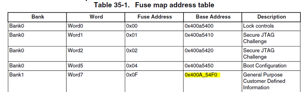

where in Vybrid registers is stored a unique MCU identifier, like SIM_UIDx on Kinetis?

you can use OTP memory space (see following table from RM) together with other identifiers from OTP memory MSCM module ( MSCM_CPxTYPE and others )
to program fuses use Vybrid Sample Code.
/Jiri

general purpose customer defined information field also can be used.
But have to correct previous reply (better later then never): Vybrid 64 bit Unique ID is located in OTP Bank 0 word 1 and 2. More in Security reference manual.

Hi Jiri,
Thank you, that helps.
