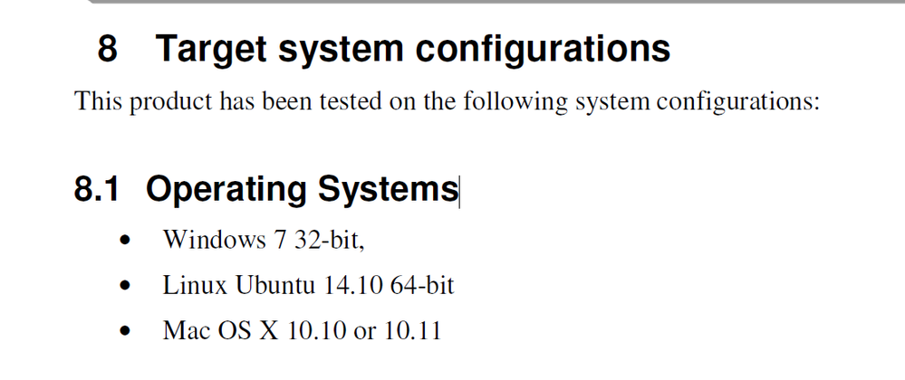

Hello xiuli,
Sorry for that  so far the KSDK project generator  only support these system :
we can find this on the DOC : KSDK Project Generator Release Notes - 2.0.pdf .
You can test it on other system , and i have test , it also can work on Windows 7 64 bit .
Hope it helps
