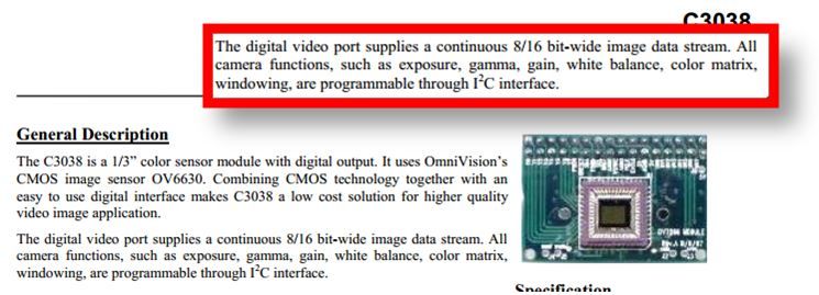

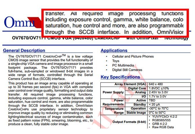

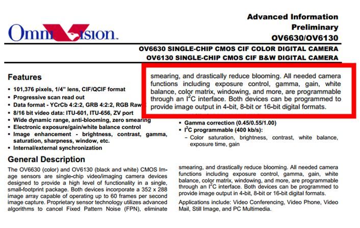

To comply with the rule that mentions that “One processor - No auxiliary processor or other programmable device is allowed”. Participants must check the camera used for the competition.
The camera cannot have a processing unit that processes the image for localization, polarization, auto contrast or auto focus. The only authorization is for a compression engine (no image processing, only compression).
An Analog to Digital external converter can be used. Such as AD7276/AD7277/AD7278.
For any additional cameras, please contact your Regional Freescale Cup Coordinator. They can confirm if the camera can be used and it will be added to this list for further inquiries.
Camera Allowed:
Some restricted cameras and some examples why:
  • OV-2540
    • This camera can be programmed and processes the image output. Not allowed.
  • CM-26N/P
This camera has • Auto gain, • Auto contrast and • Auto focused.

This camera can´t be used. This camera is programmable and as is mentioned in the Datasheet "This Device can be programmed to provide image output in various fully processed and encoded formats". The only processor allowed to be used is the Main Freescale 32 bit Microcontroller.

Si leen los articulos veran que tienen mucha información sobre ellos, y codigos de sobra. Quisiera que aclararan si estos modulos de camara se pueden utilizar, ya que el OV7670 esta entre los sensores que no pueden ser utilizados, pero este es exactamente igual que el OV7620 y el OV7640 en cuestion de funcionalidades.
Como sabran la empresa o compañia encargada de fabricar todos los sensores antes mencionados es OmniVision http://www.ovt.com, esta es propietaria de una finterfaz de comunicación llamada Serial Camera Control Bus (SCCB) http://www.ovt.com/download_document.php?type=document&DID=63, que es la que utlizan estos 3 ultimos sensores antes mencionados. A lo que he leido, este bus se utiliza como dice el mismo para control y configuración, no se si ha esto se le considere programable y estos sensores ya integran un conversor de video anologo a digital, que igual no se si esto lo consideren como procesador. Quisiera que aclararan eso sobre estos sensores, lo que pienso es de que si no se puede utilizar el OV7670 por contar con el Serial Camera Control Bus, tampoco se puede utilizar el OV7620 ni el OV7640, y todo aquel cuente con ese bus. Y si es que se puede, que ya los chinos lo han hecho, pues para que todos los participantes puedan tambien usarlos.
